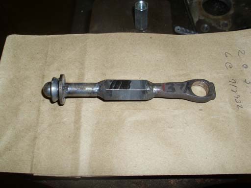

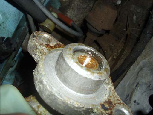

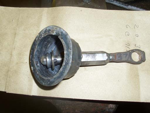

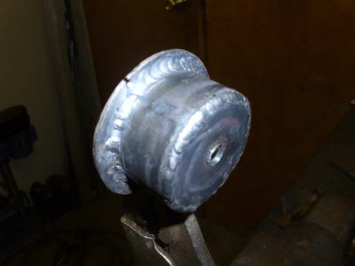

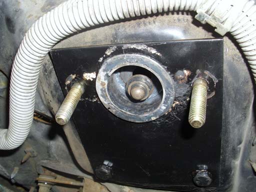

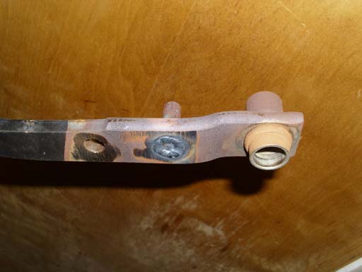

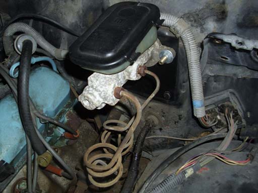

Default Re: Under the index for under a grand!
I removed the power brake booster and made the necessary mods to convert it to manual. Now the right way to do this is get the pieces from a manual brake S-10 or late 70s Camaro or Nova but they just aren't that common anymore. I took lots of pics of the pieces that I made to help anyone doing this to do it correctly. I've seen more than a couple of "professionally prepped" S and SS cars crash because this wasn't done right.
I made the cup out of a piece of 15/8 exh tubing and some 16 ga. scrap. The plate for the firewall is made from 1/8 flatstock. the rod is made out of the orig. rod that I cut out of the rear of the booster and some 3/8 rod. I threaded the ends and joined them with a coupling nut and tig welded them together. The rod should be just less than 4" long fron c/l of mounting hole to end of rod. At the end of the rod, weld on a 3/4" dia washer. Slot the cup end so that the mounting end of the rod just makes it through but the washer won't.
Take the orig. pedal and grind off the weld on the mounting stud and reweld it in the empty upper hole in the pedal. Done, assemble.

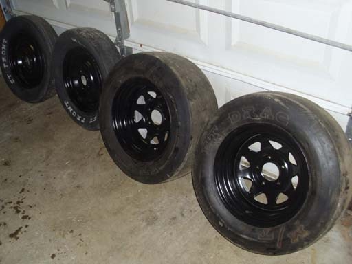

Tire package consists of 27" M/Ts in front and 8.5x26s in the rear on 15x4 GM spare tire wheels and 15x8 wagon wheels. The tires came out of the"I'm not going to use em" pile and the wheels are out of the "wheel" pile at the salvage yard. Throw in a can of semi-gloss black NAPA paint and total wheel and tire package costs $35. That's done.

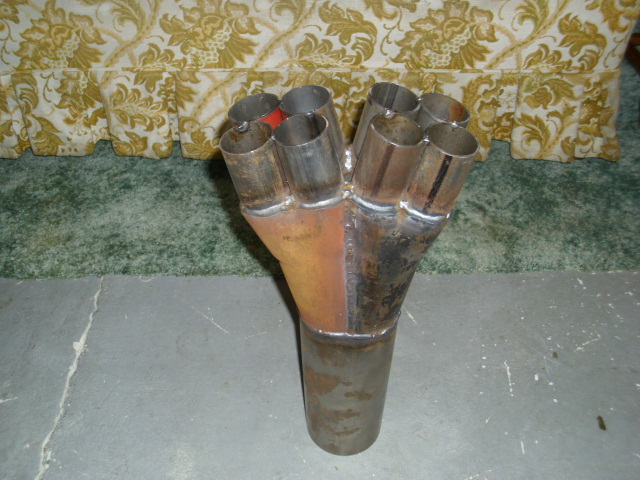

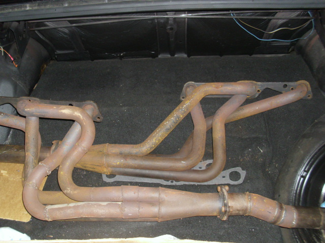

I scored a set of ???? headers at the salvage yard off of a 78 Firebird. They didn't want to fit but moving around a couple of tubes fixed that. They're 15/8 dia. tubes that are too big for this deal but they're good enough to start with. Price? Fix the countermans leaky 650 Holley.
Maybe later in this project I'll try and connect some tubes to this.
