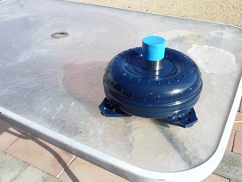

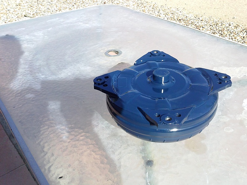

This is the first one done , of several ordered for the 302 2V NHRA gift combo..
This one to be tested in January, hopefully
I got a few lbs out of it by cutting away most of the mounting ring..Down to 17 lbs now
I think I can get another lb. or two out by thinning down the tabs some more, and the pilot plate, on the next batch..

Mark........is that a 7 or 8inch converter?
Marty Buth 3657 STK
Marty Buth is offline   Reply With Quote
Old 12-17-2013, 10:46 AM   #5
Posts: 7,837
Likes: 2,931
Default Re: U/SA Ford Converters..
Marty, That's an Opel style 8" reproduced with all new parts.
I don't believe a 7 inch would work in this application..Not enough rpm's due to the 2bbl restriction.
