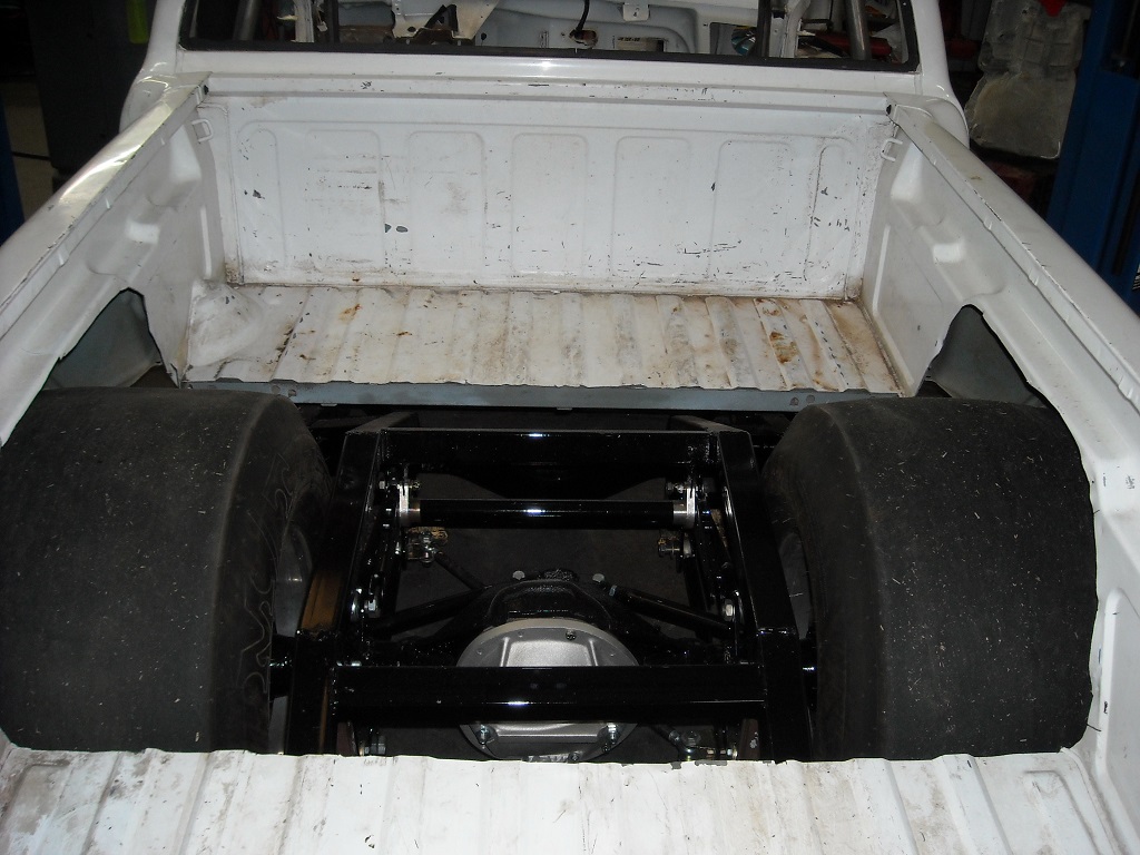

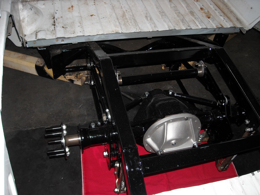

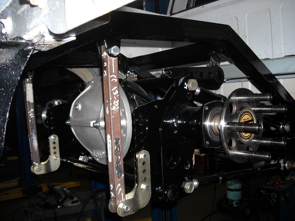

to close out today's post we have two shots of rear assembly with bed in place.
ID:	26603   Click image for larger version
Larry Woodfin 471W

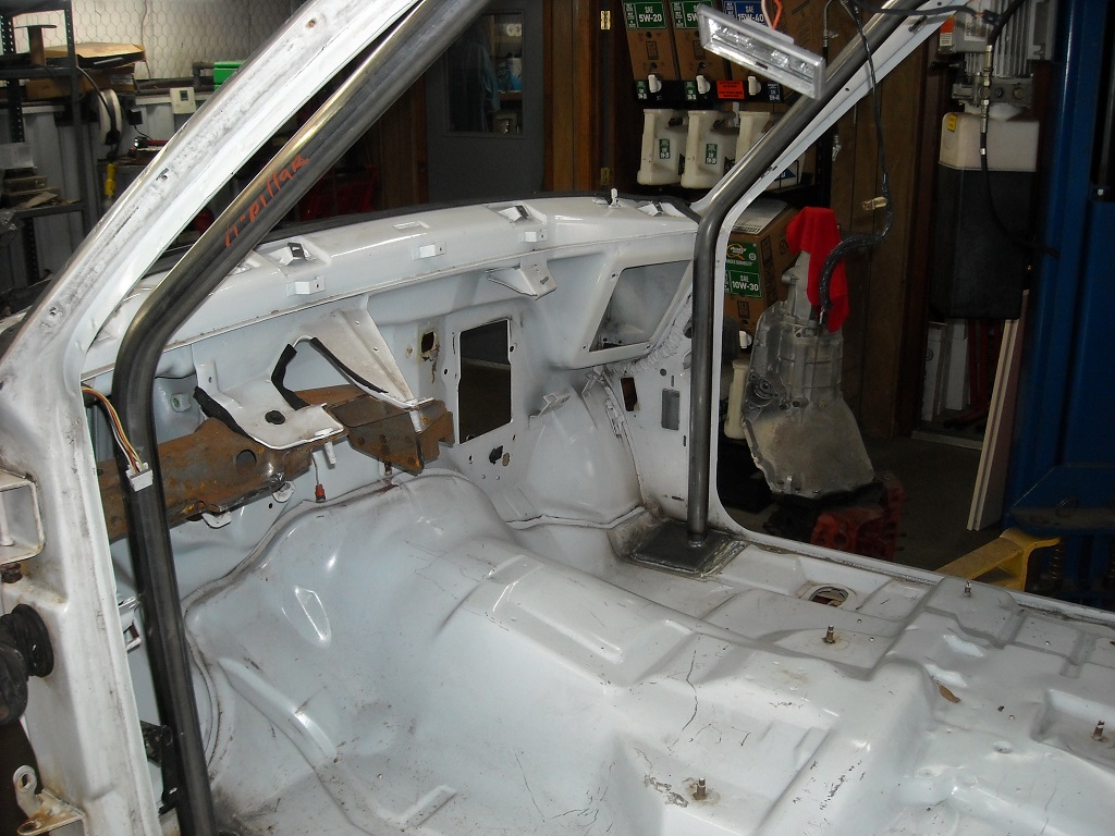

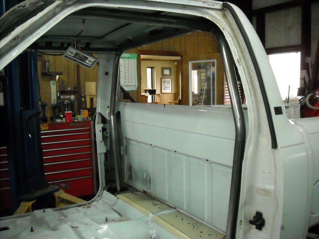

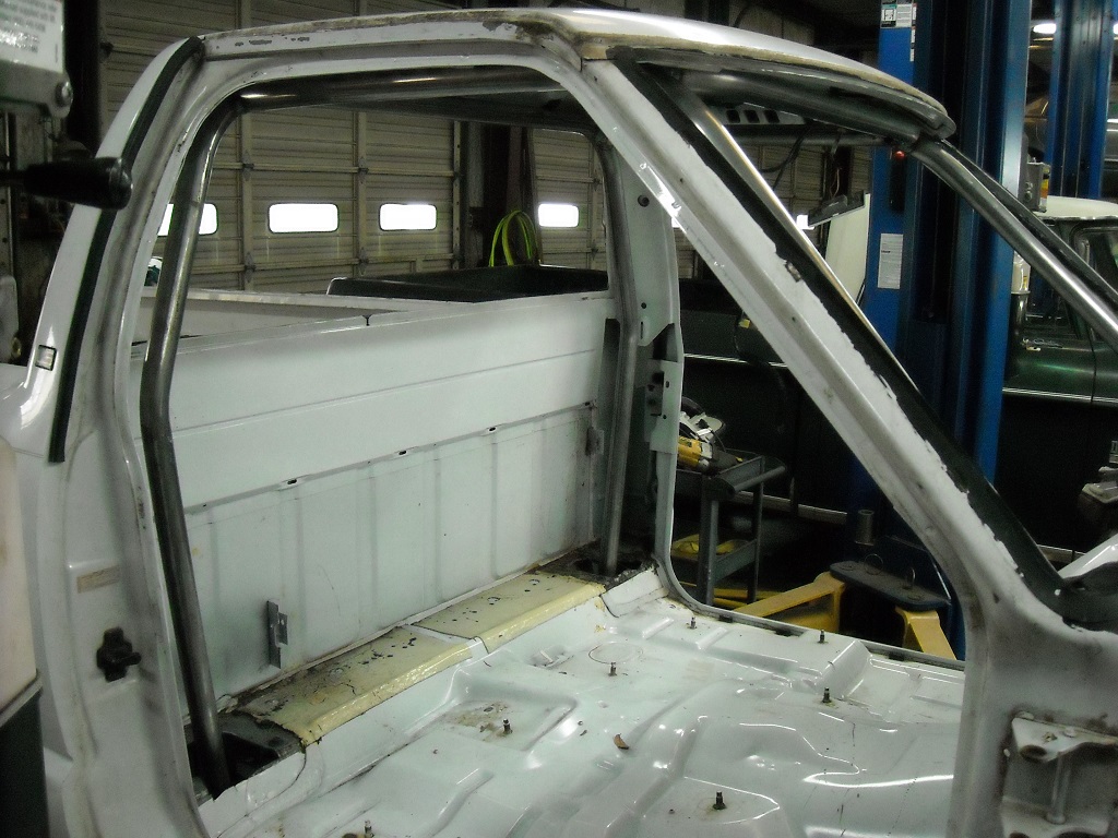

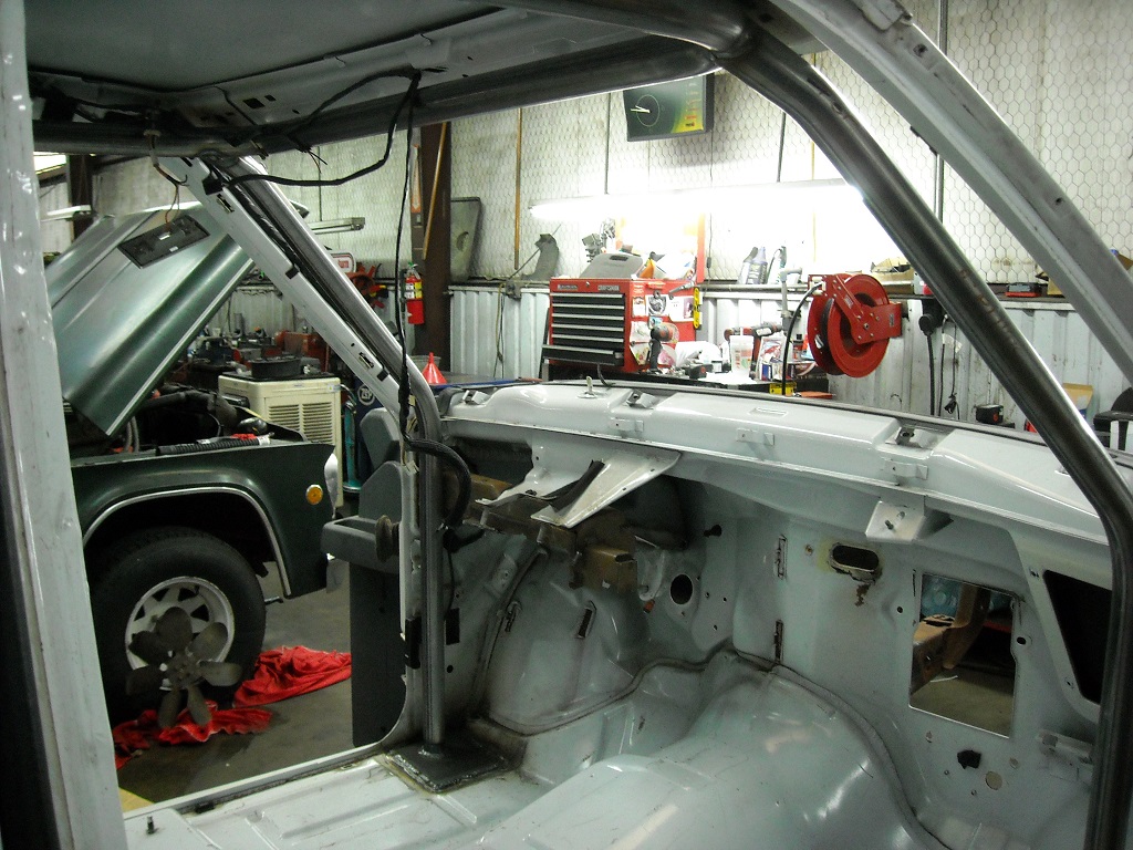

On the 18th day of Christmas good progress did result with roll cage bars in installed.
The middle half crew hit some good licks today. Roll bar, halo bar, A pillar bars installed and finished welded.

Maybe I am not seeing your photos well enough but any car with a factory frame requires that the cage be welded to the frame. If I am seeing your photos correctly, it looks like you have plates welded to the floor, that is only legal on a unibody type chassis. Am I missing something?

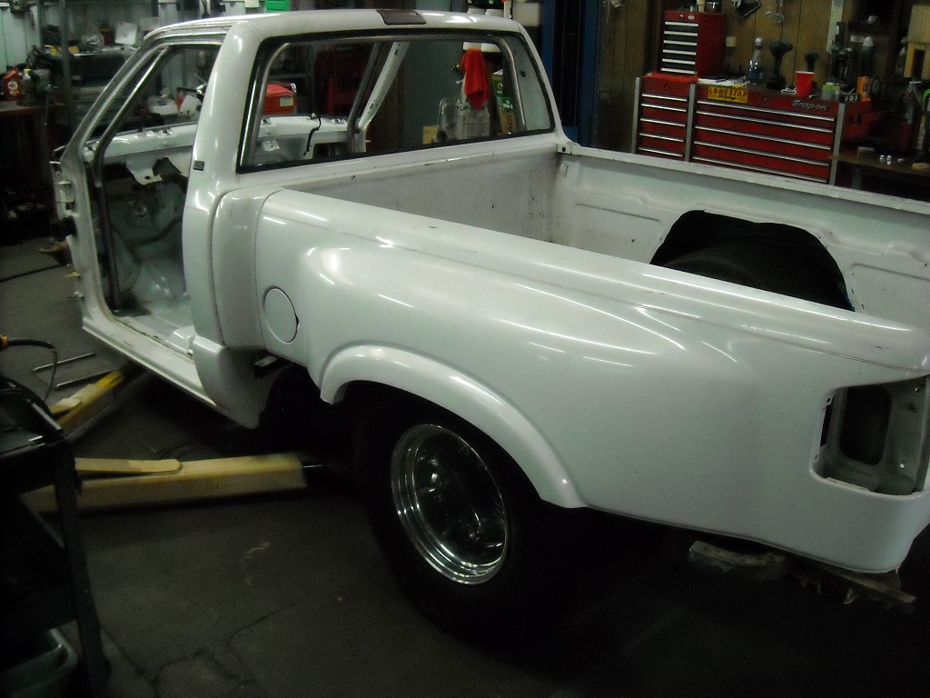

these 3 photos show the lower bed trim removed making ready for paint work. And the 32 x 14 M/T tucked in nicely

Jim, the main hoop legs are through the floor into the frame.
With the front A bars, because of the cab mount and frame location it worked out best to plate the floor and add an outrigger under the floor to frame. The frame turns inward before the A bar location.
In addition, the cab floor is "robust" and double thickness in that location.
Larry Woodfin 471W

Dwight Southerland
