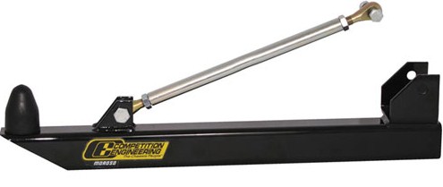

OK, I've seen these "anti roll bars" but I don't know exactly how they work.
(1) Does anybody have a link to a site or sites with pics and explanations and/or installation instructions for these devices ?
(2) Is this what most of the quicker Stockers are running ?
(3) Would these be required on a 4000 lb + car, such as a wagon ? Or will the large amount of weight make these extreme components unnecessary ?
(4) The adjustable uppers that were mentioned. Does that mean that most cars need shorter arms ? or longer ?
(5) Are the different length arms to change pinion angle, or suspension geometry ?
(6) What about the coil spring "slapper' bars ? Are they totally useless for Stockers ? Sorry about my ignorance on this subject. I've just never used any of the above products.
http://www.jegs.com/p/Competition-En...37234/10002/-1

This site is a good source for answering a lot of your questions.
http://www.baselinesuspensions.com/
Necessary to me would be anything that gives an advantage, but at the same time, I had a 71 Monte Carlo SS 454 back in the early 80's that would run 11.50's with 1.50 sixty foot times with nothing but air shocks on the rear, lol.

Aftermarket adjustable upper arms are legal, but you must use the factory front attachment point (no extra holes). The rear attachment point can be relocated.

Wow ! This blows my preconceived ideas out of the water. That site has some great info.
One of the main things I got from it that might pertain to a heavy coil spring Stocker is that if you are getting 100% traction without a lot of front end rise, then don't loosen up the front or use 90/10 shocks. What you want is to use all your power for propelling the car forward. If front end rise is not needed for traction, then your ET will be better if all your power is moving the car forward.
Also, I read that you want soft springs to help traction. But, this guy says that for a stock suspension coil spring car, you want stiff springs, so that all the weight is used to push the tires into the track. If the springs are soft, then on the initial hit, the body will squat, instead of pushing down on the tires. Makes sense to me.
And the part about the '71 Monte with nothing but air shocks: if I remember correctly, that was a heavy body style, very similar to the '69-'77 Pontiac GP. So, that may be a further indication that all these fancy suspension pieces are not needed for a HEAVY, low buck Stocker. Would probably be a good idea to start with stiffer bushings, stronger springs, air bags and stiff shocks--try that and see how it works, before spending a bunch on parts that may not be needed at all.
And the part about the '71 Monte with nothing but air shocks: if I remember correctly, that was a heavy body style, very similar to the '69-'77 Pontiac GP. So, that may be a further indication that all these fancy suspension pieces are not needed for a HEAVY, low buck Stocker. Would probably be a good idea to start with stiffer bushings, stronger springs, air bags and stiff shocks--try that and see how it works, before spending a bunch on parts that may not be needed at all. [/QUOTE

What I got out of what the guy said, that I think might apply to a HEAVY (over 4000lbs) Stocker is that IF you are getting 100% traction without a super loose front suspension and fancy rear suspension pieces, then you will not go any quicker by using these other parts and methods.
I am thinking that one of these HEAVY cars, especially a wagon, will have enuff weight on the rear tires to get max traction with only stiff bushings, springs, shocks and air bags.
But hey, I could be wrong. If so, it won't be the 1st time.
The only reason NOT to go with the latest and greatest is $$. If you have the coins to spend, by all means, by the best of everything. But I'm talking about what you can get by with for a very low budget build.
