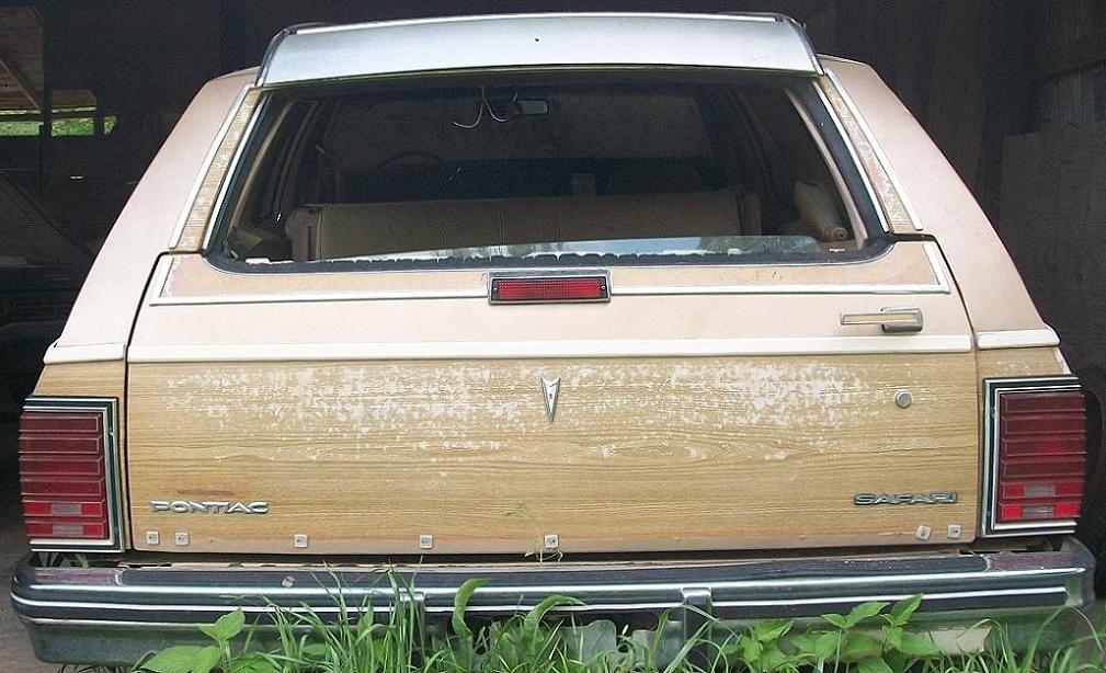

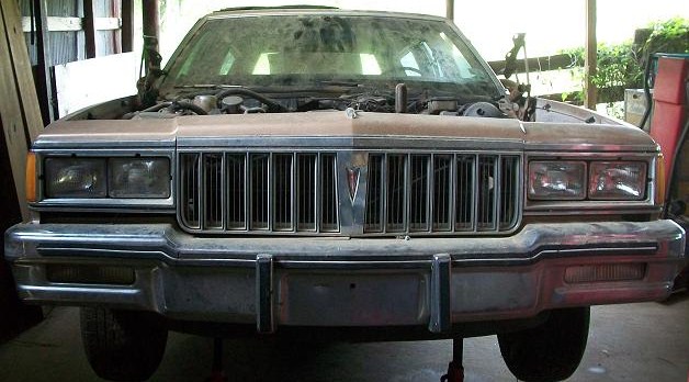

Now, I have a Safari wagon I bought for a future bracket car. Haven't started on it yet. It's not old enuff to run a Pontiac engine in Stock--mid 80's. But, since I already have it, and as you say, I may not like driving the heavy car, I just thought that it might be a good idea to go ahead and put the 455 into the wagon and just see what I can get out of it. If I can't get it to go quick enuff at the aprox weight it would need to be for a '76 wagon, then at least I'd have a Pontiac powered bracket battle wagon. It would be using the stuff I already have, to do the testing with.
So what do you think about that idea ?
