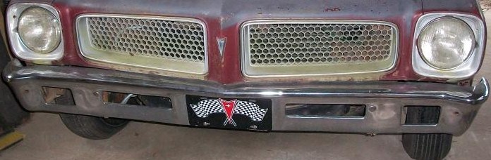

By the way, the name of my wagon is "Woody". And the name of my '68 is "Early Bird". And here's a couple of more racin plates TJ did.

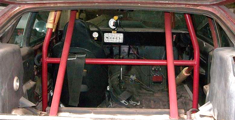

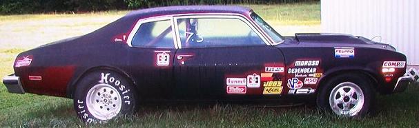

So, if I tried to convert my Vent to a Stocker, I'd have a lot of changes to make. As you can see below, it has nice bars, but the dash has been replaced with sheet metal. And it has ladder bars, which would need replacing with Cal-Tracs or at the very least, homemade slappers.
Also would need a stock hood, front bumper, and I'm sure, lots of other stuff to make it pass tech. So, I might come out better trying to find a decent stock body, and start from scratch. That's the reasons I haven't considered it as a potential Stocker.
