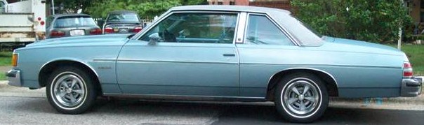

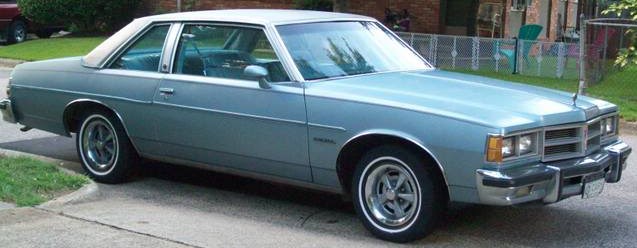

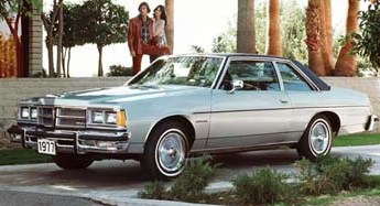

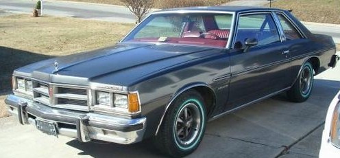

OK, if the online info is correct, here is a '77 base model Bonneville. The one I like for racing is the 2-door with the swept back roof line. Back in the old days we called 'em "fastback" . It appears as if the bottom of the rear window is aprox half way of the rear wheel well. This will give that extra little bit of side vision I mentioned.
The 4-door rear window doesn't go as far back, so there is less side vision. And the Landau roof has much less glass and more metal. So this type roof will give less side vision than the other 2-door roof type.
But there is a problem with these cars. There ain't many left. Most have been crushed long ago. They are not a sporty lookin car like a Bird, so there is just no demand for 'em. So, just finding one of 'em may be tuff. Therefore, I'll expand my possible choices to provide a better chance of finding a suitable car.

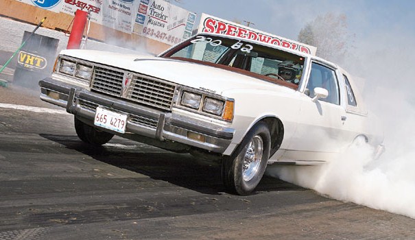

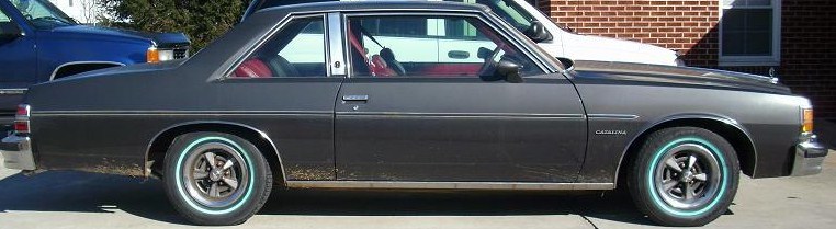

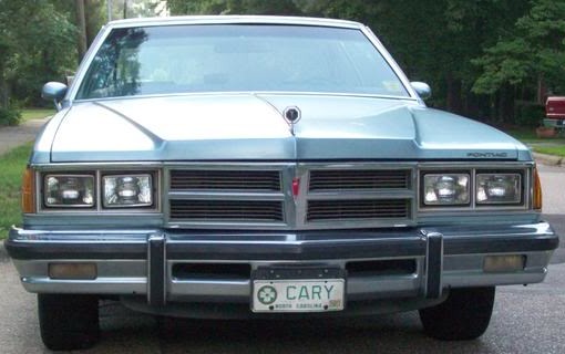

OK, the Catalina was the same size as the Bonnie, but had a different grill. They also had the same fastback roof line in the 2-door models. So, one of these will do just as good.
The '78's had a different grill than the '77's. I found a '78 on the track.
What do ya'll think would be the chances of finding one of these old cars in usable condition ?

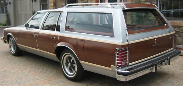

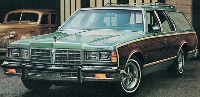

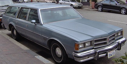

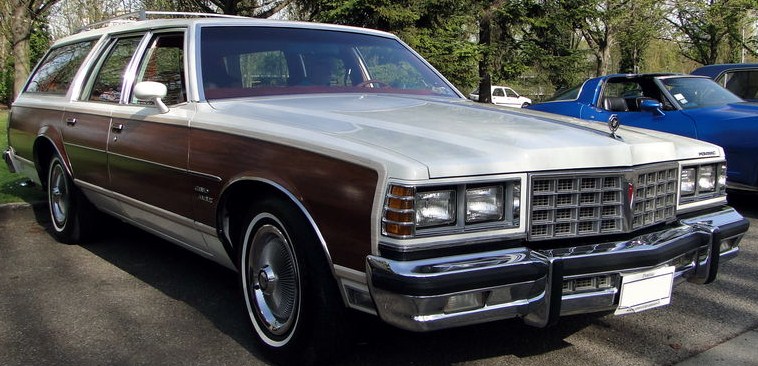

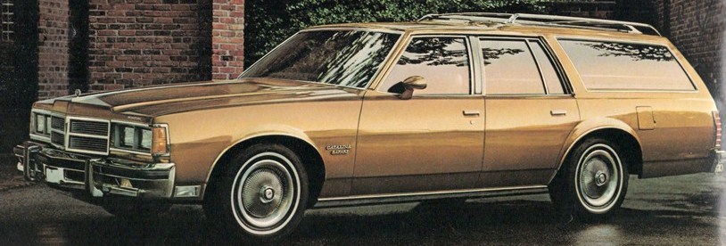

Then, of course to make N/SA @ 14.5 lbs/hp, would require a wagon or a GP SJ. But because of the lack of side vision, I've decided not to use a GP.
http://www.classracerinfo.com/Engine...spx?ENGINE=764
http://www.classracerinfo.com/NHRA_Classes.aspx
Either a Cat or a Grand Safari wagon would do nicely, and have PLENTY of side vision. Besides having more weight over the rear tires, the extra side vision is another advantage of using a wagon.
