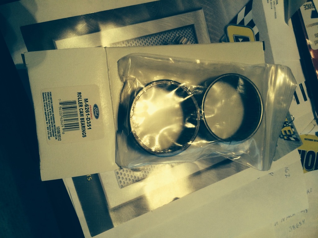

If it wasn't a cleveland I wouldn't be using these, but it does make for a nice way to restrict the oil, should have posted them a few pics back with the rest of the cam gear

With that statement, I just have to ask. Why are they so much better ?
Can those cam beearings be used with an iron cam ? Comp told me 400lbs open was about it for an iron cam but those 1427's are 500 @ .600" so a tick less with the Boss cam.

Old 11-12-2015, 09:01 AM   #20
Bill Diehl
Bill Diehl's Avatar
Join Date: Dec 2013
Posts: 311
Liked 9 Times in 8 Posts
Default Re: Boss Mustang stocker
The exhaust crossover, lead is too much of a hassle, tin leaks....aluminum plate works much better and don't have to worry about anything falling out or finding its way into the exhaust bowl. and I am able to swap manifolds without screwing around with it.
