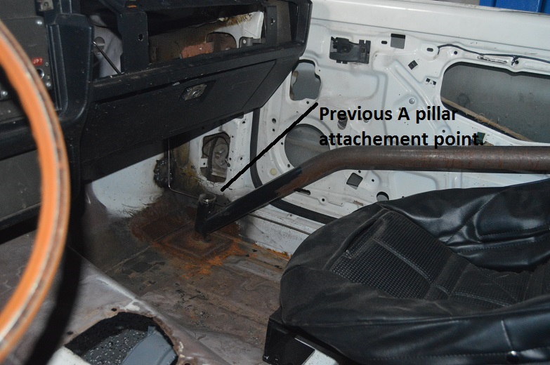

I decided since I'm running in a slow class I would remove the halo and the 'A' pillar bars.
Once I installed the swing out bar I mocked up the JAZ plastic seats.
I wouldn't do that until you speak to a Tech man! I think that you'll find that if you have a bar in the car, it must be legal. A cage has a 1 5/8 main hoop, a bar must have 1 3/4. And you must have a legal bar to use your Jaz seats.
I spoke with a Division 5 Tech man and I was told a Non-Certified roll bar was ok, didn't ask about the seats to be honest with you.
I removed parts of the cage/roll bar that don't affect the integrity of the rest of the roll bar, in my estimation. The cage/roll bar is 1 3/4. Hey I'm no expert on any of this but I tried to do my homework before removing it. I appreciate the feedback and will check further with the Tech people.
I'm hoping that it's not one of those deals where you ask 4 people and get 4 different answers.
Worst comes to worst I'll get it certified, if it won't certify I'll remove it and install some less safe OEM seats and the 30 pound back seat.
Thanks, Kelly

The bar doesn't need to be certified but it would still have to be legal. If the main hoop is 1 3/4 then you should be OK.

What Billy is saying is correct, regardless of whether the rules require a roll bar or not, if it is in the car, it has to be legal. Kind of a funny rule but that's the way it is.

It is 1 3/4 mild steel. Should be legal...as per Billy anyway. The closest NHRA inspector is 7 hours away.
