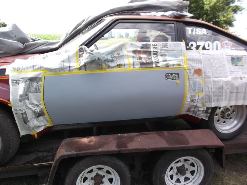

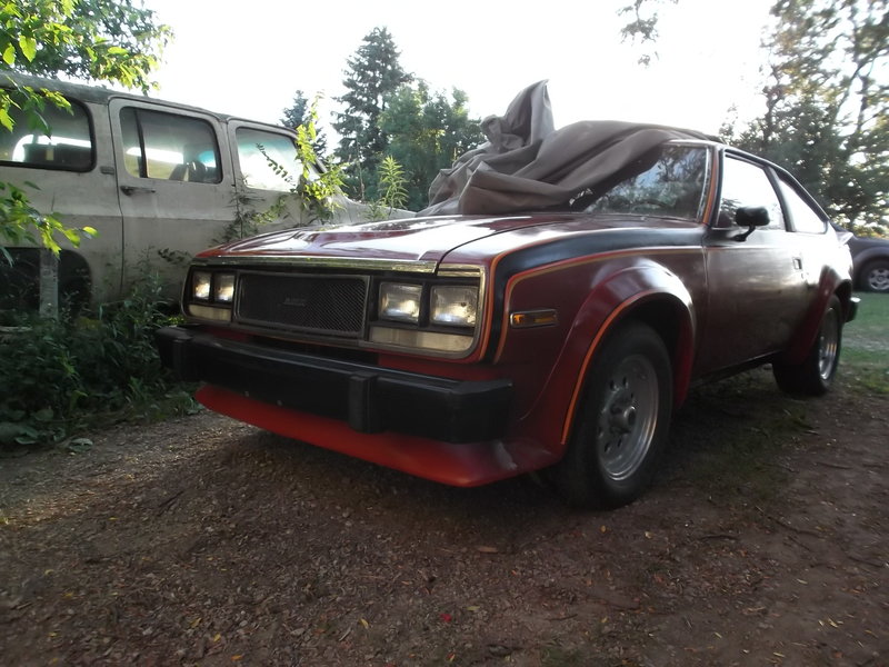

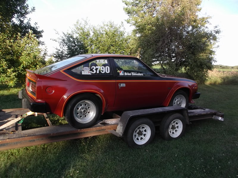

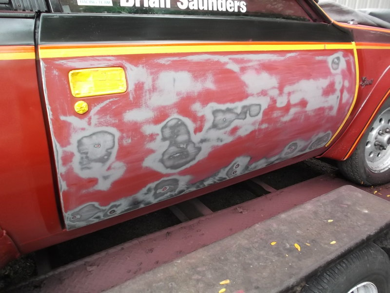

I'm humping on this paint job as hard as I can go...I want this thing done!
Driver door is back on the car and all refinished, nice to look at one whole side of the car and see it shine after all these years. Passenger door and some window trim gets the treatment this coming weekend if it doesn't rain, and that should just about finish all the painting. I'll turn my attention back to mechanical stuff after that. (brake system, fuel lines.)
It amazes me how many suppers I can miss and not really care when I get into these frantic work modes every night and weekend when the weather is good. I'm taking weight out of the car on a daily basis purely by working it off! But that's a good thing, I have to stay ahead of those Fords somehow.

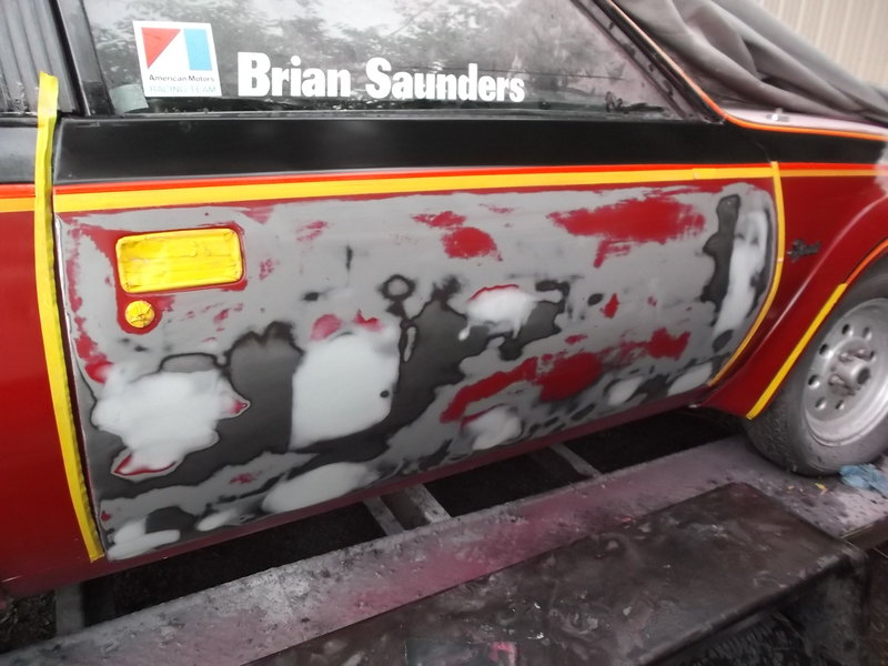

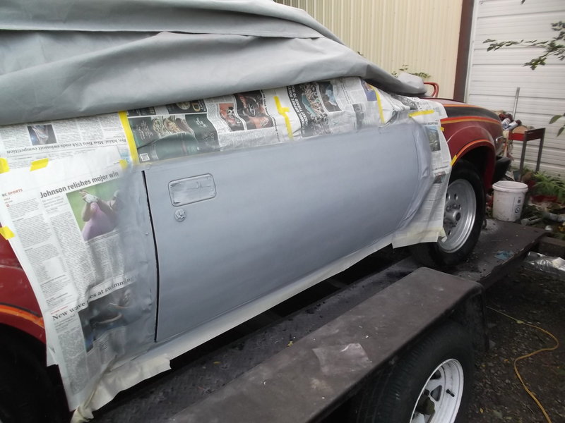

...and the passenger side door gets it's turn. It rained most of last weekend and held up the show some, but this weekend was fabulous.
After this all that's left on paint are the window surround trim front and back. Those get done tomorrow. Finished!!
There are some sub-par areas that I'll eventually re-do, maybe in a couple years, but it's time to turn attention to other things under the car, like brake lines and fuel system, and get this thing to a track. I can get by with it looking like it is for now.

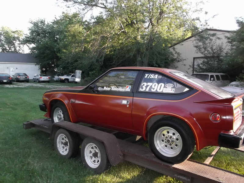

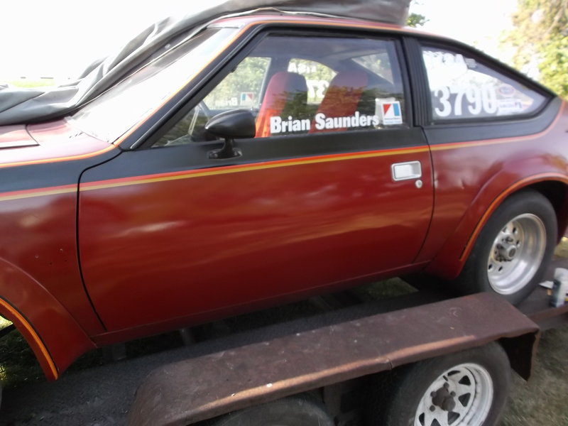

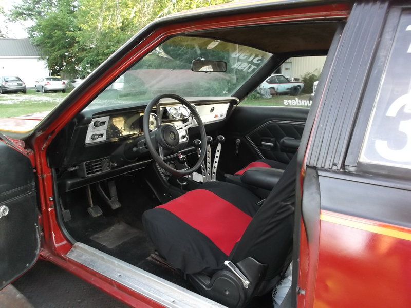

Paint is DONE. (big sigh of relief). Car is pretty much assembled and painted into the proper AMX model it needed to be to get it into T and is now going back to the auto shop in town for new fuel and brake lines and some finish work underneath. It's getting to be time to make this thing RUN. I truly hope to get some runs on this car this year so I have some data to munch on over the winter.
Been a long haul to this point, but I'm not anywhere close to laying down on this project!
