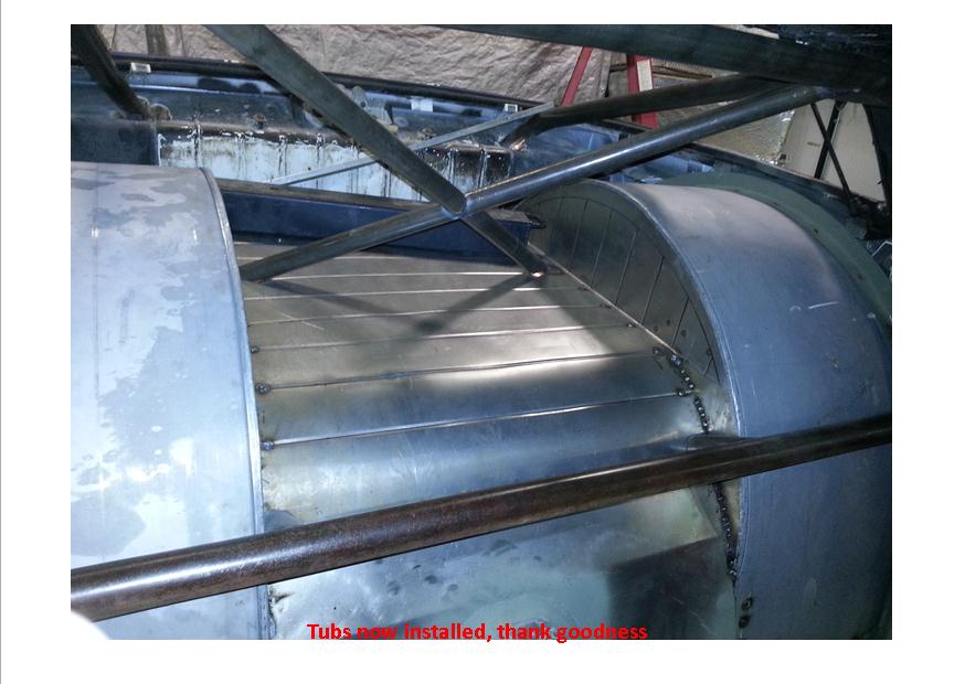

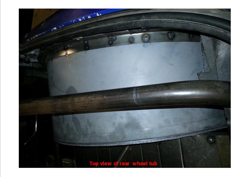

Most of these are of wheel tubs, enjoy!

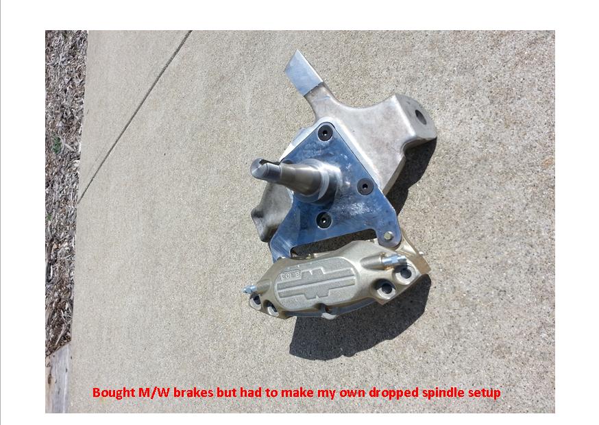

more wheel tub fun on these and start of my lowered spindle using Mark Williams brakes

Mostly me, my son has done all of the welding on the cage. I had it all bent and fitted before taking it to my son's shop. David has been on other projects mostly building headers. However, I did the headers on the Corvette. David welded up the rear end housing and back brace. He welded the four link brackets and shock mounts. He welded the wishbone as well. It left his shop after we got it to that point.
