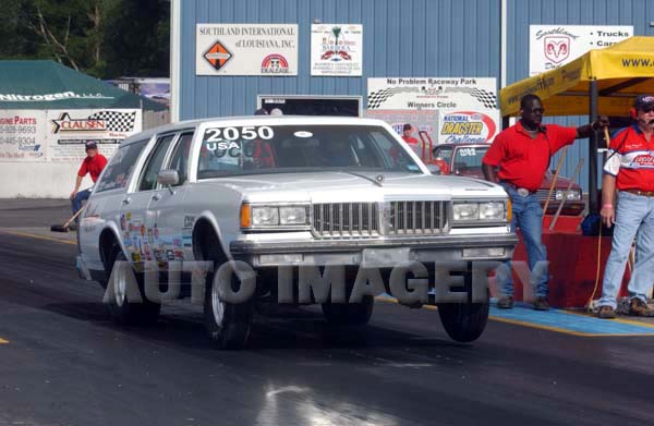

I ran a small box on my old 307 wagon. 13.70's with about 5k in it.

pic
