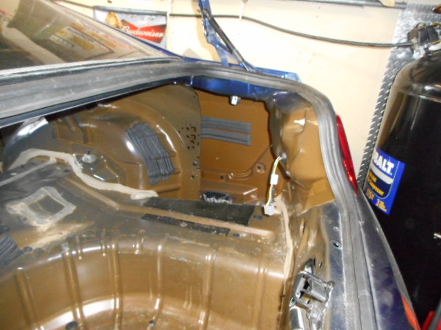

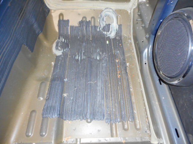

Moving into the really fun part of stripping the car , sound deadener, and seam sealer

Default Re: The "eBay CJ!" (2010 Mustang CJ 352 Build)
I used dry ice...made it much easier.
Thanks Rich, I have been using a heat gun and gasket scraper, works OK, seam sealer is 1/2" thick, and 1-2 inches wide, and there is lots of it.
The dry ice makes it brittle and it come up in big chunks/flakes instead of smearing.

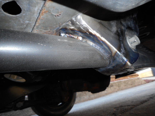

ID:	38450   Click image for larger version
Jerry Heath
I/S '93 Cobra
FS/J 2010 Mustang "Ebay CJ"
Old 03-28-2017, 10:38 AM   #37
JHeath
JHeath's Avatar
Join Date: Jul 2004
Location: Minneapolis
Posts: 786
Likes: 2,876
Liked 370 Times in 101 Posts
"eBay CJ" is back home after a 2 week visit to MPR.
