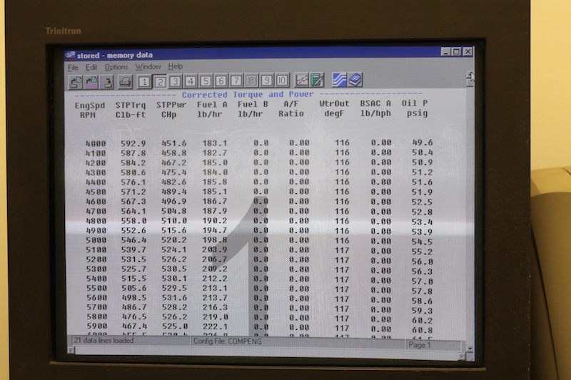

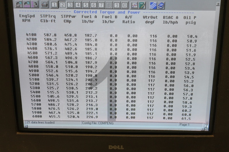

Default Re: 1971 Buick 455 GS F/SA G/SA Build
My preliminary dyno results are in, peak HP so far is 513 HP/550TQ. I will be making some changes looking for more, I will post up the results when I get done. More work and more HP 522 now.

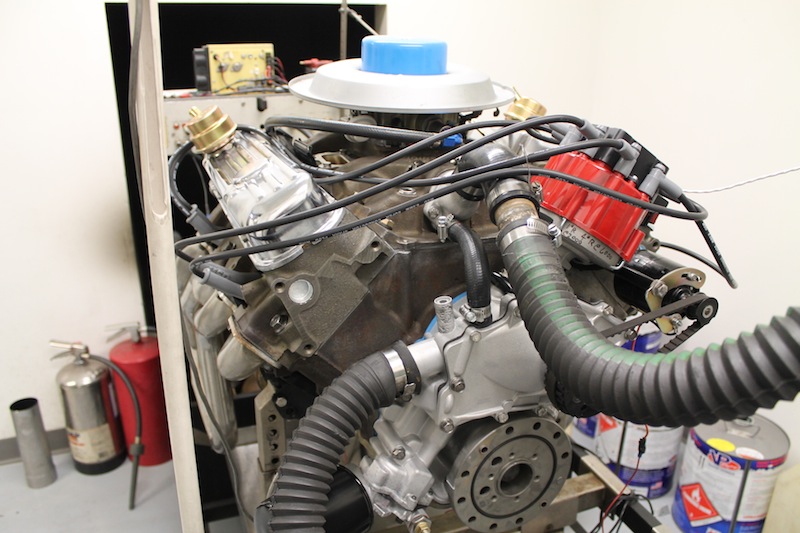

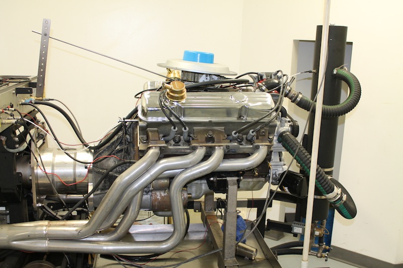

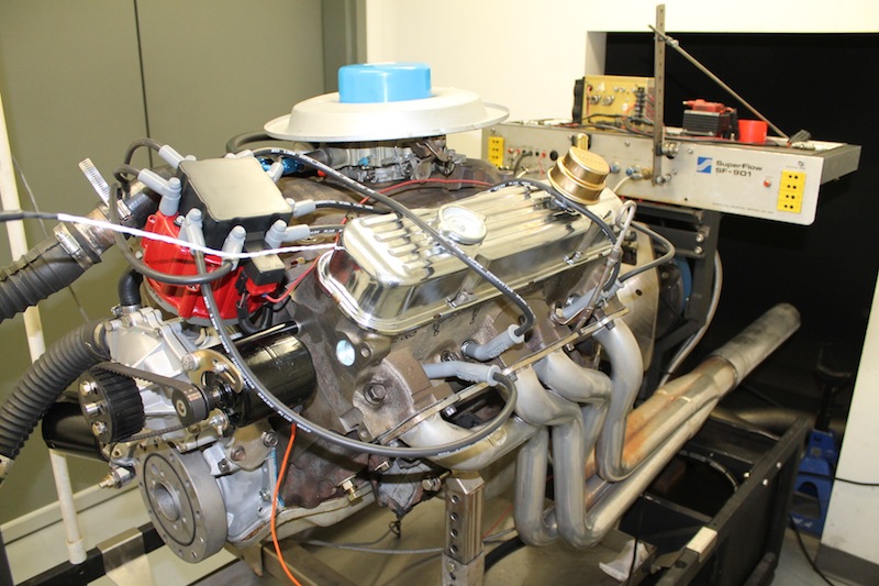

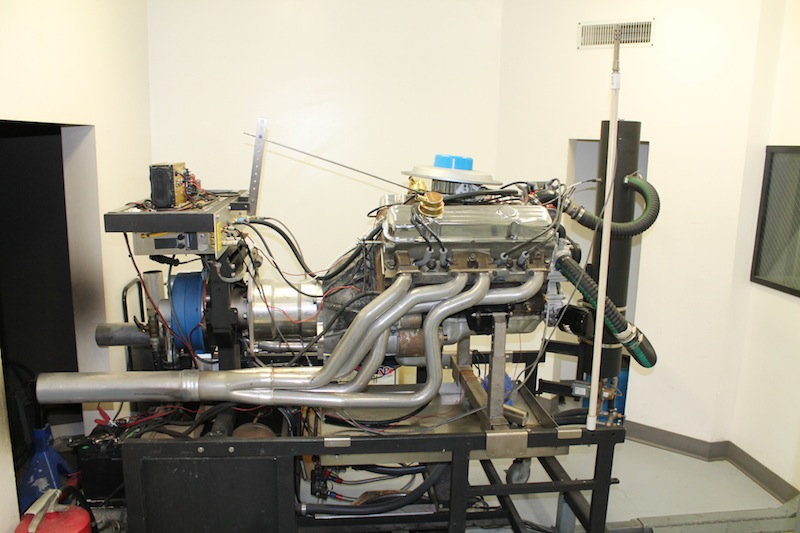

I finally finished the engine part of my F/SA build. I want to say thanks to the following people for their help.
Harold Bettes
Jim Lewis
John Lewis
Chris Skaling
Dyno test from before the engine had been gone through is on the first page of this thread, dyno test of the finished product below.

Originally Posted by Steve Lackey View Post
Have you tried any header tuning while on the dyno? These engines really benefit from the exhaust scavenging. That is why the original Stage 2 heads were so effective.
I tried different lengths of extensions, the best were in the pictures. Merge collectors were not tested.
