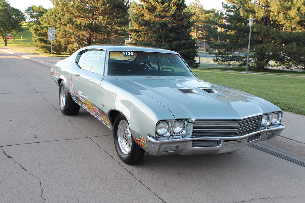

Old 10-09-2019, 07:57 PM   #96
HP HUNTER
Join Date: Feb 2012
Location: Colorado Springs Colorado/Thousand Oaks Ca
Posts: 656
Likes: 82
Liked 372 Times in 129 Posts
Default Re: 1971 Buick 455 GS F/SA G/SA Build
After finishing the year with a best of 1.01 under the F/SA index losing some MPH since the engine was first built, I suspect the short block of being tired I plan to build a new short block and change the trans this winter. Of course I will post pictures as I go, followed with a dyno test with data, followed with a track test. I need to make a decision on the bore size and piston to wall clearance, I think I've got a handle on the bearing clearance from my previous testing. I will be nitrating the crank this time as well.
HP HUNTER is offline   Reply With Quote
