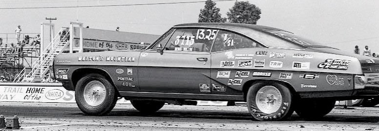

Just ran across this pic. I'm posting it because it's just sort of a rare Stocker. It's not that the car itself was rare. But I just don't remember seeing many of these big Pontiacs, from that time period, on the track. And this looks to have been a serious Stocker.
It has "Walton's Mountain" on the front fender.

Old 02-06-2020, 05:42 PM   #376
R. Thorne
Join Date: May 2009
Posts: 184
Likes: 79
Liked 107 Times in 35 Posts
That’s Bruce Walton. He had a 74 GTO later.
