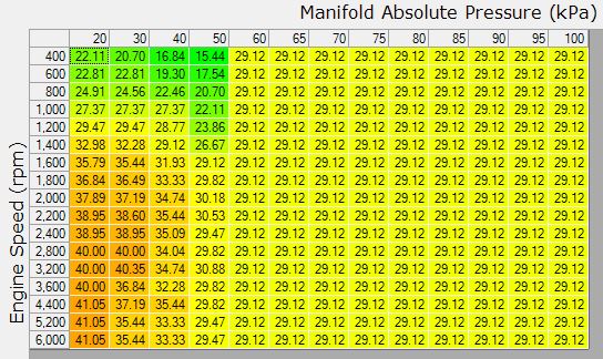

Attached is a picture of the main spark table. I only felt the need to modify it from 60 kPa to 100 being that once you go to full throttle the map sensor reads between 98-100. I pretty much copied this table for both high and low octane mode so there is no way the car can change it. The other thing I did was modify the minimum timing table to have a minimum 29 degrees of advance throughout the rpm range. If there are any other tables anyone would like to see, I'll gladly post them on here.
What is the compression ratio of this engine? What fuel being used ? Fuel table would be cool.

Default Re: Not for Nuthin' But Close!
where do you find the minimum timing table
