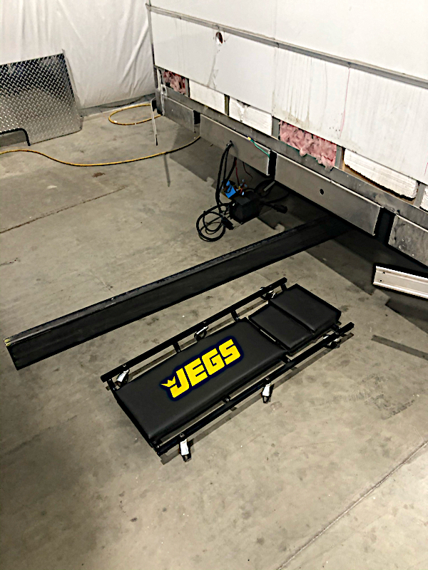

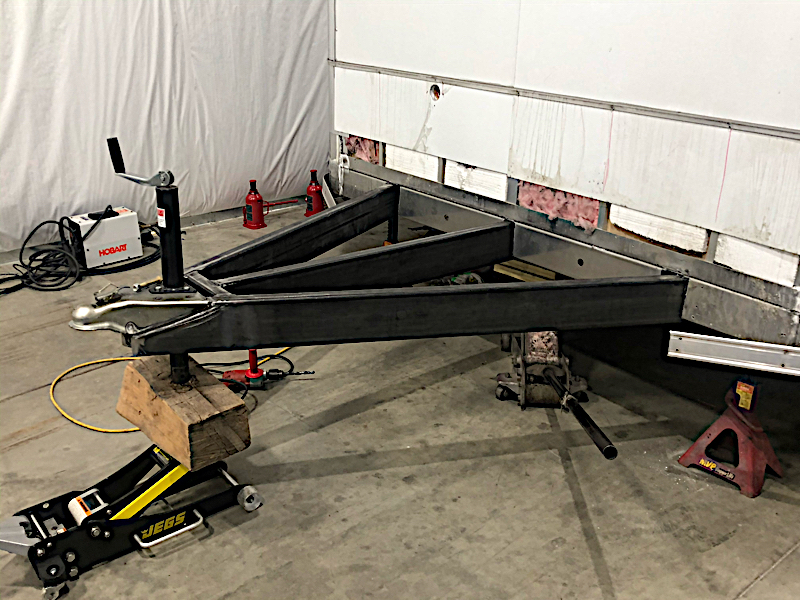

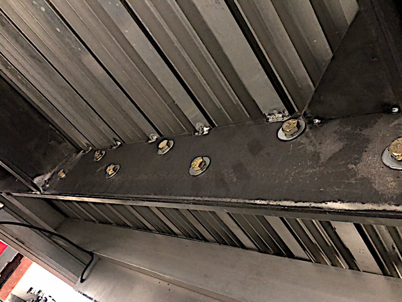

Just an update on the trailer. Just in case anybody else
has the same problem. We cut out the aluminum tongue
A-frame . We built a replacement out of 2x6 steel tubing
and bolted the A-frame to the trailers frame rails.
Just have to paint now but better than what we started
with.
