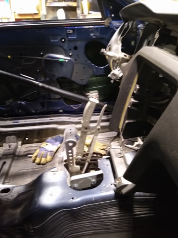

Race car building tip ; make sure anything you install has clearance around everything ,
back in November I installed my G-Force G101A, at that time I didn't have the dash in, so I grabbed it and this is what happened. Yup, it hit the dash pad ,not even near into 1st gear. So I called Long Shifters and lucky for me ,they had a mount that moved the shifter back 2 inches.

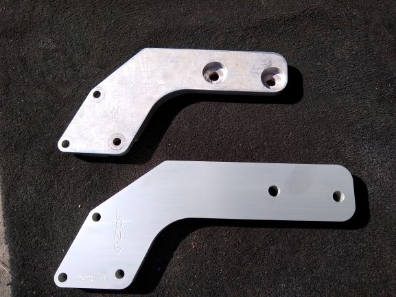

Here was the solution, new mount, and 3 longer shift rods !
