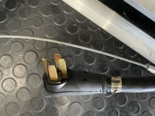

Here is a photo of the trailer plug and the fuse box.

thats a 50 amp rv plug, you can get an adapter 50 to 15 amp at a rv stove .plug into a 120 outlet and you should have pover to your outlets

Get an RV adapter pigtail. 50A-125/250V to 15A-125V then your 120V panel will be powered up.
