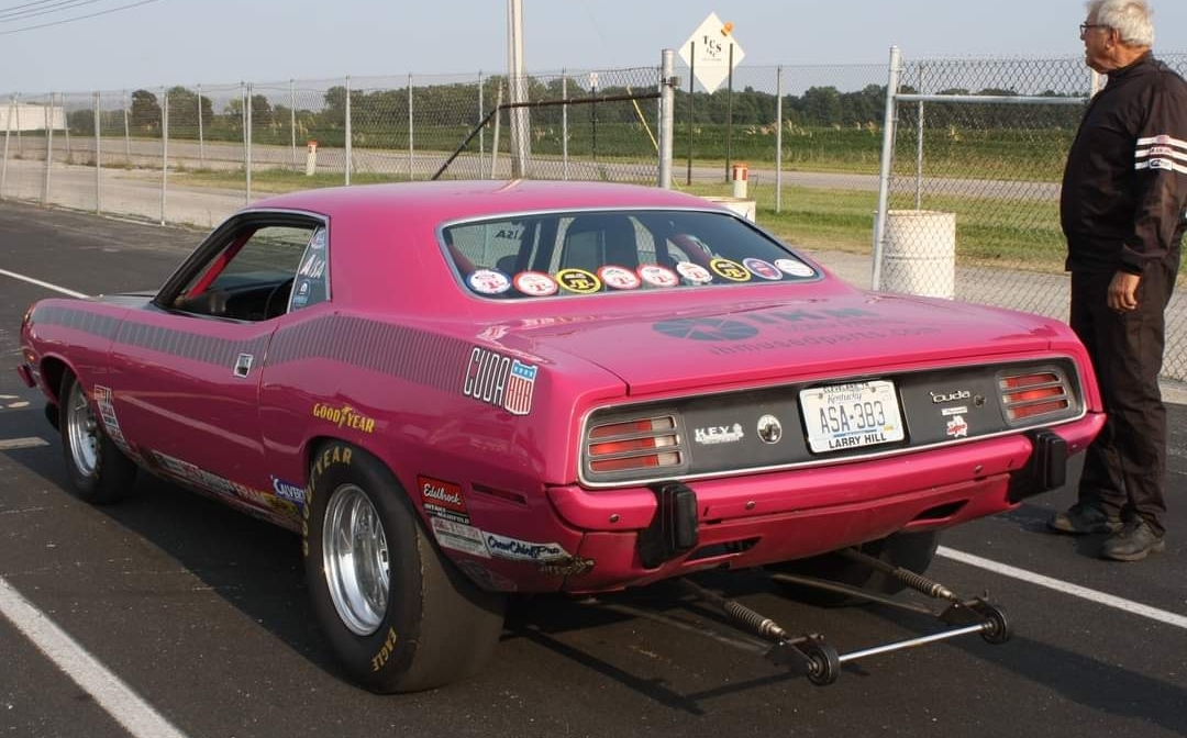

Default Re: Dumbo The Flying Elephant
Ran across this on facecrack.⁷
I have never seen that one. Thanks
I wonder what I was watching.
