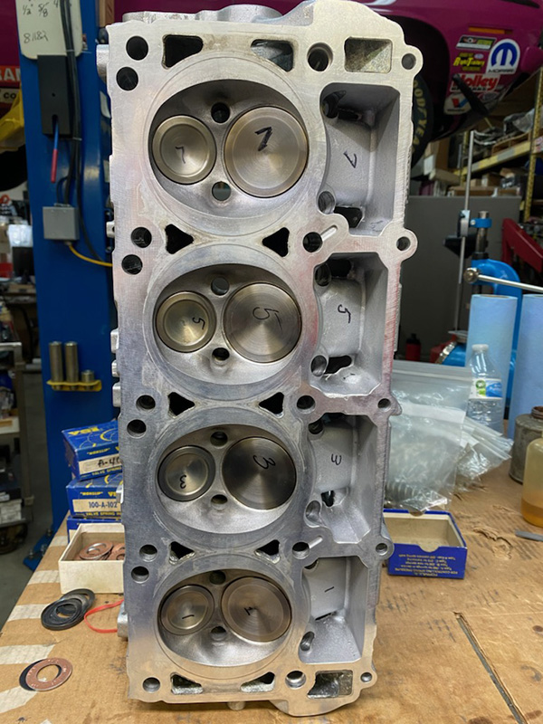

Today I should be able to assign springs to valves get them assembled and verify coil bind. It should be a busy day.
The reason for all the lathe work is the valve guide bosses have a healthy radius at the bottom where the spring cup or shim seat. Some of the shims I had to turn the OD down to fit the pockets or bore the ID to go over the guide boss.

After redoing my coil bind set up three times I'm confident that my numbers are correct and repeatable. I have one head ready to bolt on for final check for clearance from coil bind. The other head is clean with seals, valves, and ready for spring assignment with assembly. It took two sets of springs to get eight springs on the intakes to all be at the same open and seat pressure. The exhaust side springs are 10 pounds lighter on open and seat.
