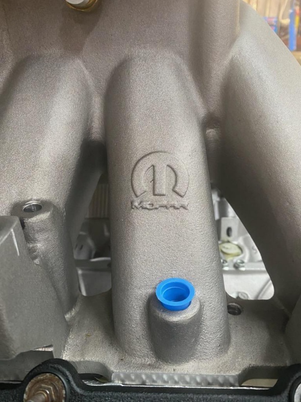

Dumbo is starting to develop a little bit of a personality. I still need to button up the oil pan, but that will be tomorrow.

Ta-Dah
I just hope its not Ta-Dud!
I hope to record a Dyno pull or two next week, good or bad. As Steve Kopein would say " I just got's to know "
I know I'm not finished but there is a list of things I want to try on the next one. Patsy says I'm hopeless.
