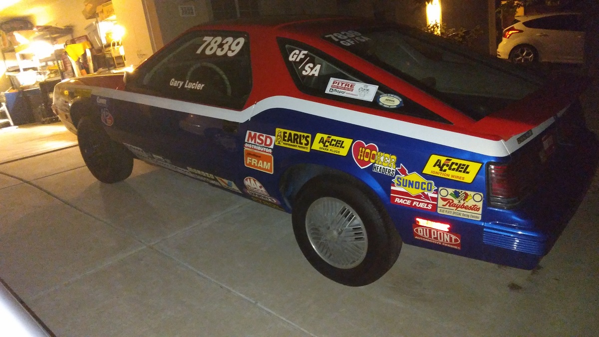

Just testing my resized pics so I can continue.
Through the years... ![]() I think I have the aspect ratio on resized pics correct if they post so I can get back to the build and changes over time. We shall see. |

The first (White) photo reminds me of 87 Daytona Pacifica turbo 1 DF/SA car I had way back when. I enjoy your story
