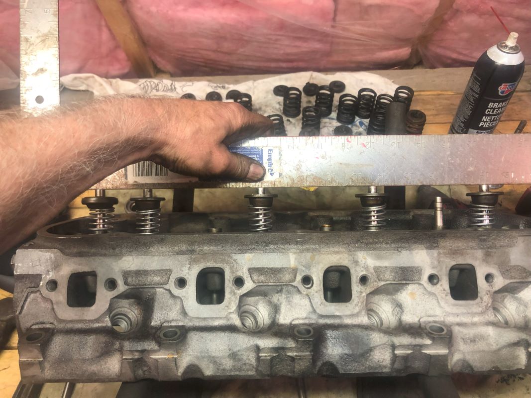

I didn't like how low the 30* seat was so I tried to save it and did! So I got all intakes and exh valves ground and the valve job done.
15/30/45seat/60throat
After that was done I used lite springs to check stem height. Got them all within .012 by trimming the tip. Now I have to work on the installed height.
Of course nothing is easy, the LED light on my valve grinder went bad and it's continually flashing, try to see where the contact is with that! LOL!

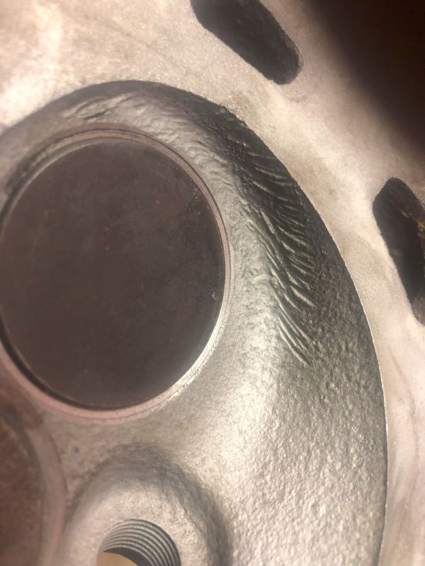

After the heads were cleaned I see this mess in one chamber, not sure if someone chattered a stone or something let go, who knows but how do I fix it or can I fix it since you can't do anything in the chamber?
Still moving forward, so that's good.
