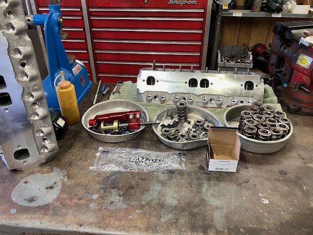

Default Re: Square 10
I have been known to say I do my best thinking, err, hallucinating when mowing or driving. Since it is the off-season for mowing, my thinking is confined to driving.
The following photos show my revolutionary design to replace valve springs. The idea came in a dream, spawned by the toughness of cable ties. The tails are located outside the valve covers to allow tension adjustments.
ID:	71906   Click image for larger version
ID:	71907   Click image for larger version
