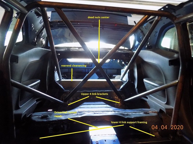

The first proto build of the Drag Pak had a leaf spring suspension. That got thrown out for a rear suspension, framing and a very busy rollage that cost 20 times the labor to build and cost. Why, so the cars could go 7s. Sound inexpensive to me, right? I happen to have one I built all by myself. Labor intensive for the normal person with good skills.I have a stick Laying next to it. I haven't had the time to get back to the project. I have built 3-4 cars in the mean time. Those builds are late 60 cars. Easy peasy! Just need to make those straight again. Someone missed the stock term or at least stock is not 100,000.00 cars to start with.

How hard/expensive is it to add a roll bar/cage to a Stocker ?

Piece of cake in a newer challenger..
Nice job, looks as though it needs carpet ….
