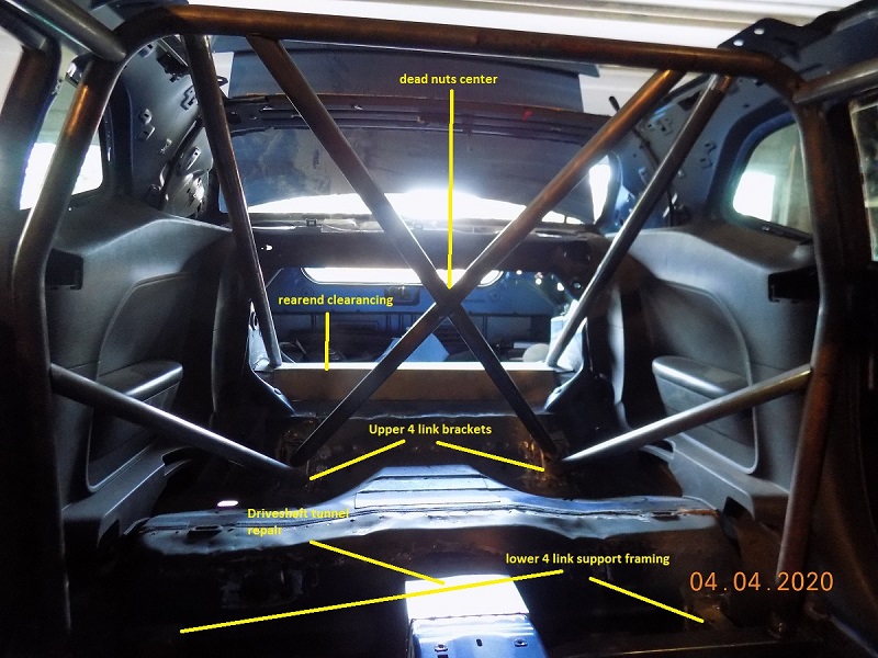

How hard/expensive is it to add a roll bar/cage to a Stocker ?

Piece of cake in a newer challenger..

Nice job, looks as though it needs carpet ….
