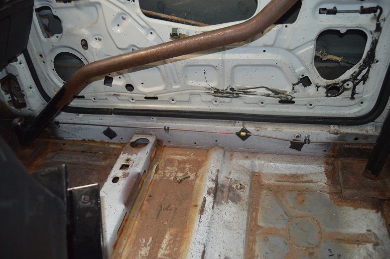

Got a little more stuff done this week.

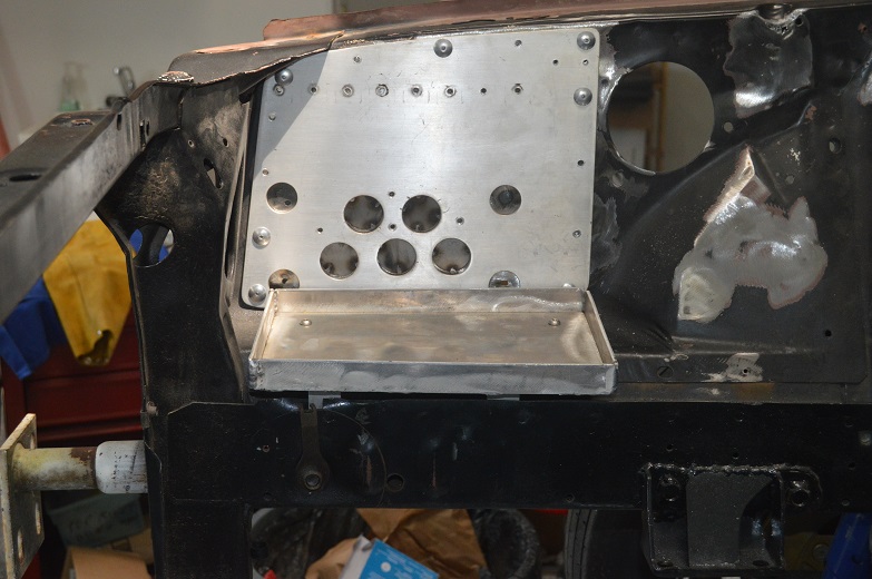

Built a battery tray out of 1/8 aluminum in my welding class, put a little lip on it and some tabs to mount it to the body. Weighs a little more than the OE tray but it's much stronger. Turned out pretty good.

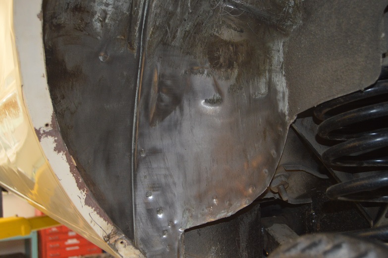

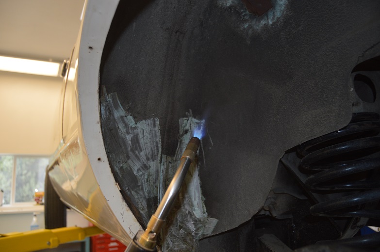

I've been scraping undercoating and seam sealer out of the rear fenderwells for a couple days now. Nasty job at best. Using a Bernzomatic to soften it up, then scraping with a putty knife. After I get most of it off I go over it with a stainless steel wire brush on my angle grinder.

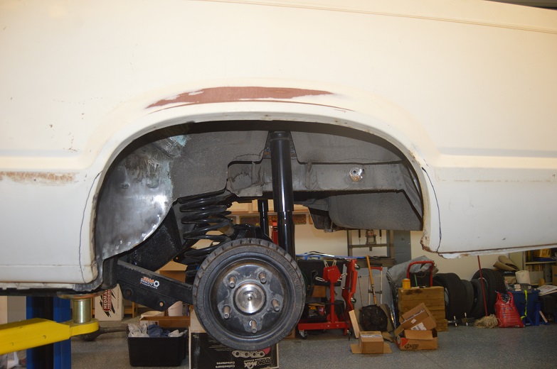

I think the issue with the rear tire clearance will be resolved once I get the fenderwell lips folded up and add at least one inch clearance at the front and back of the wheel wells, as per the rule book you can go up to 2 inches.

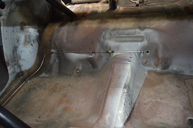

Finally got the rear brake lines installed. I followed the old rear brake line which routes through the firewall of the passenger side of the car, down along the door sill then across to the driver’s side under the rear seat and exiting to the rear axle. I'm not sure I like the new (new to me anyway) brake lines made out of copper/nickel. It's easy to bend but it looks like it may be easy to dent and therefore pinch off.
