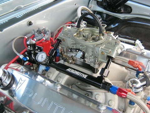

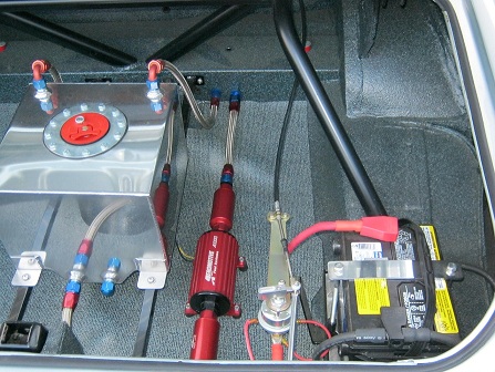

I went with all Aeromotive stuff on my '70 Nova. Their fuel log/return style regulator is awesome and really cleans up the engine compartment. A 2" throttle stop fits underneith nicely. I'm currently running the A1000 pump with great results and have been 9.80's @ 136 mph. After a full season, not even a hiccup.........
