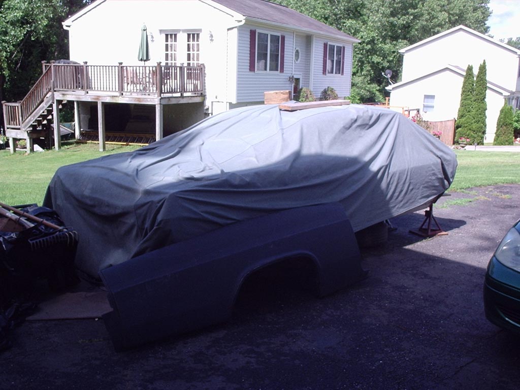

Had a 1968 Impala original 427/425 car with matching #'s, pulled that motor out and built a Stocker with a 396/325 , Jerico and ran I/S at 4095 pounds. ran 11.70's best, but never really flogged it. I sold car to collector who restored it back to the stock 427/425 car, lliks great. I purchased all the race parts back from him, rear end, ignition, motor ect., now i am building a 1965 Impala with the same motor combo to run I or H Stock.

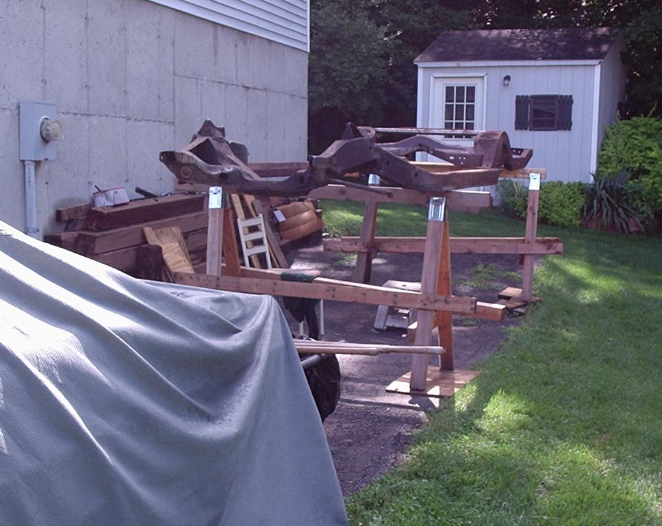

Thanks Billy, my brother Ed ran a 69 Nova in V/SA with the 230 in the eighties with Joe Huestis, Div 1 car, they could never get it yo run like your car though! The Impala is apart, working on the frame. Any input would be appreciated.

Re-weld the upper rear susp. crossmember to the frame while you have the body off.
Otherwise you'll have to cut holes in the floor later.
Ask me how I know...
Double gusset the lower trailing arm brackets to the frame >> <<

Thanks Mark, I am know about that problem with that crossmember pulling out, I gusset and plate all the suspension points in the rear, also a run a crossbrace from the roll bar to that upper crossmember. I did that with my 68 Impala, probaly overkill, but I never broke a part leaving up to 6500 RPM off the line.
