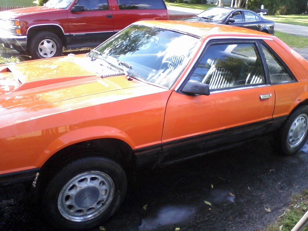

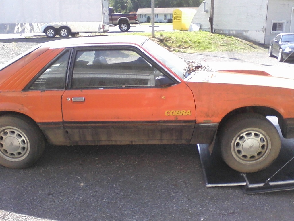

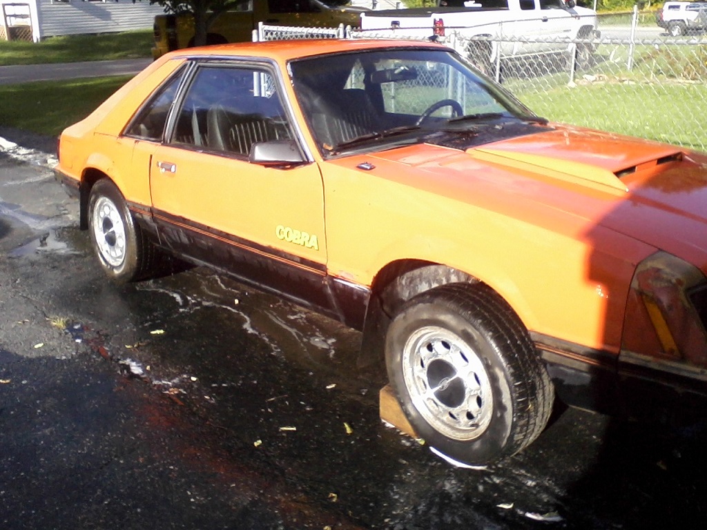

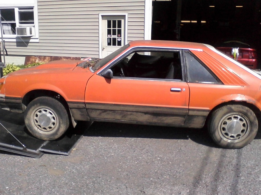

just purchased it washed it up ,now to figure out if i keep the 4 speed that is in it and 7.5 rearends i heard are not the best, but i do have the 302 which i will be using, interior is in great shape. I will keep the updates coming
