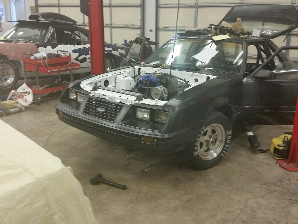

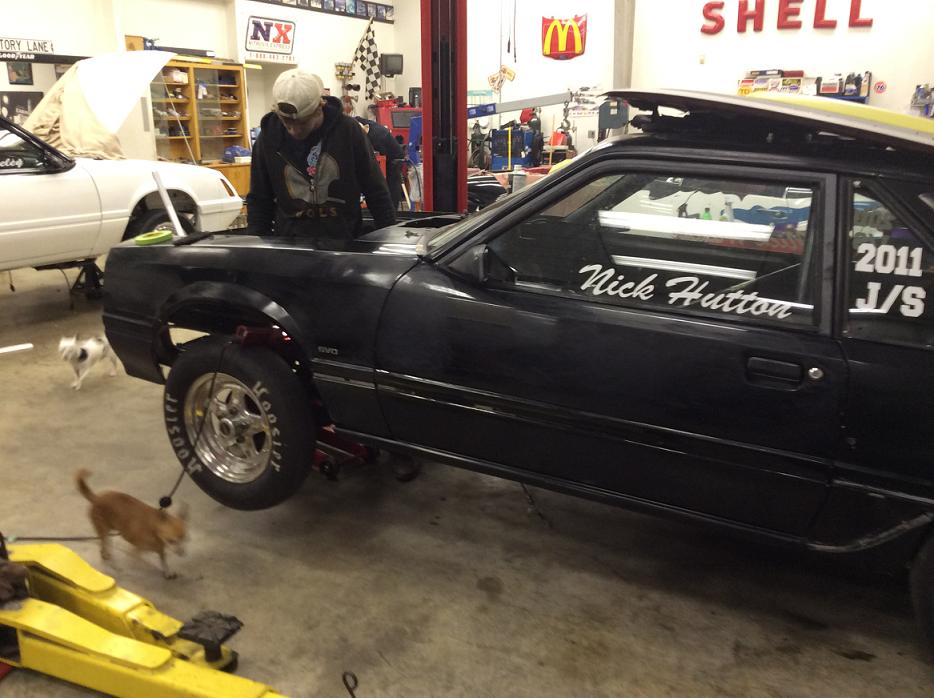

Here is this weekends work.. Its all wired and connected under the hood. Dad and Nicko did an amazing job making it look very neat.. It wont be long til we fire it up.. The interior wiring is ready for the dash and control panel and Gauge hook up then we ready for carpet.. and interior.. Coming along slowly..

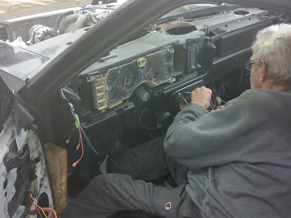

More pics from today.. We installed the nose and the dash.. Dad and Nick wiring on the dash...

Front end installed
