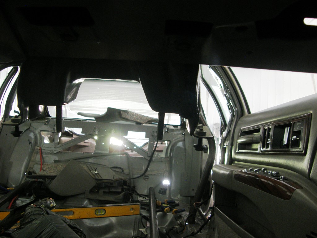

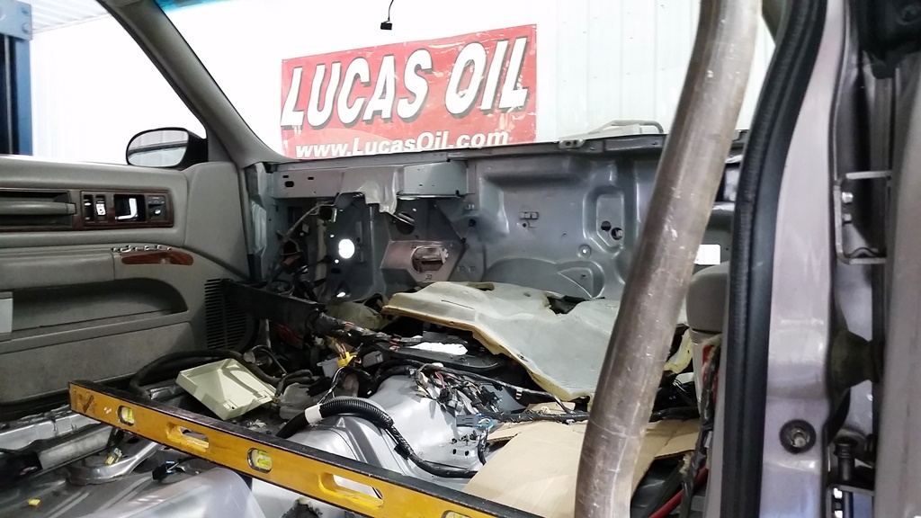

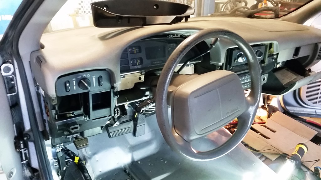

Guys, I was really busy during this process. I did get some photos occasionally. I will try and post some from time to time. I was lucky to make it to Indy with this car. Lot of hours for a 70 years old. I had some help along the way. Glenn Betz, my sons David and Ernie II. Rick Stanghetti came over from Cincinnati. Gary Powers from North Carolina was here for family and helped me some too. Ryan Betz helped some when he came out to his Uncle Glenn's. Jay Koelling came down from Indy and participated in some disassembly and cleaning.

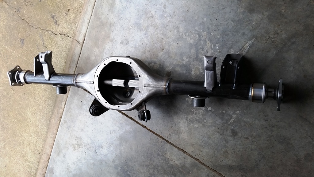

My son normally welds up the rear ends, but due to the time line, I bought the bolt in Moser housing, axles and brakes.
My racing pal out of Louisville, Larry Wilson, loaned me the Chevelle headers so I didn't have to make them myself.
This Caprice came out of North Carolina, and is a rust free, 237k miles on the original 265.
David Tincher, waterjet cut necessary pieces to get the Caprice going. I generate a dwg file and he gets it cut out.

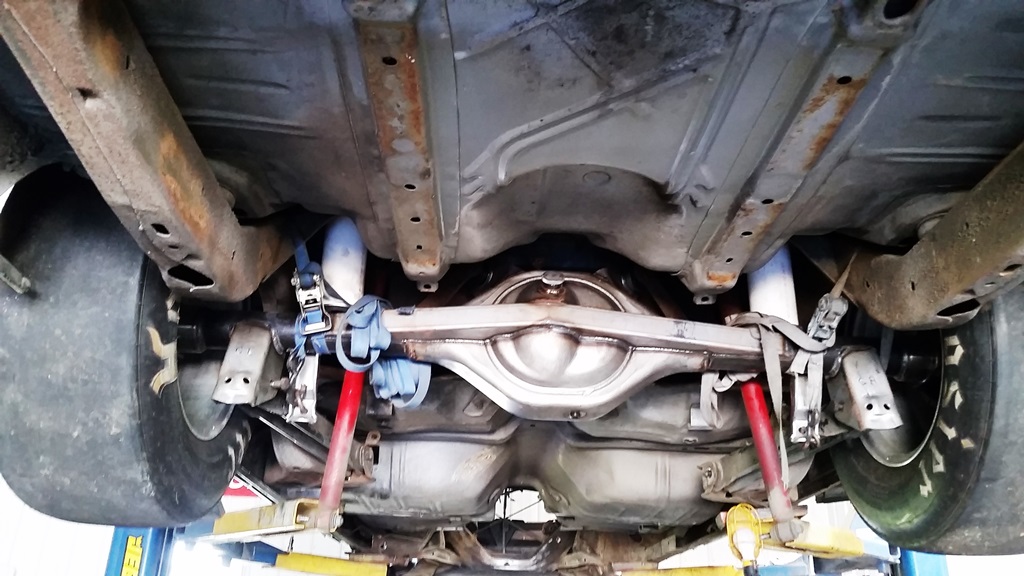

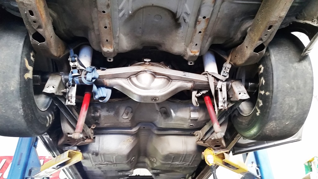

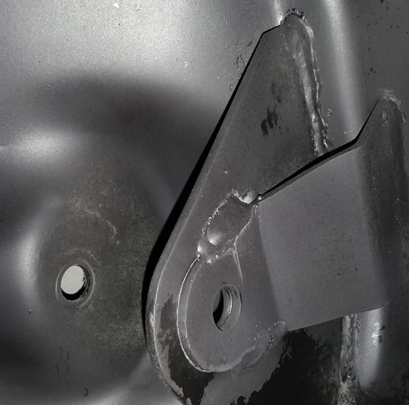

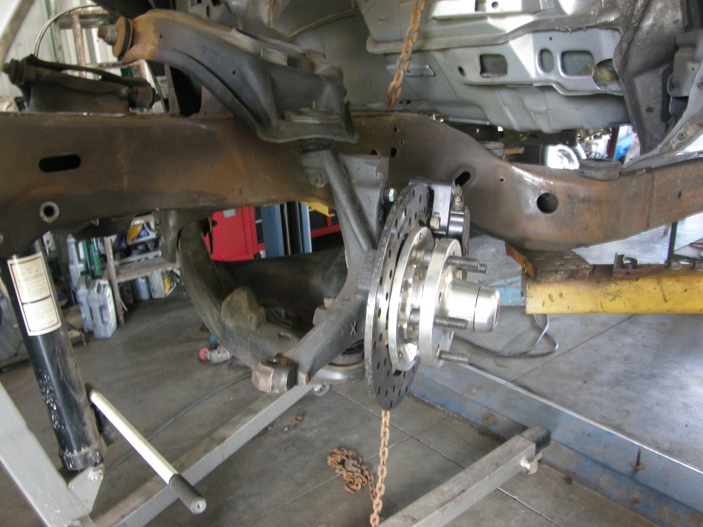

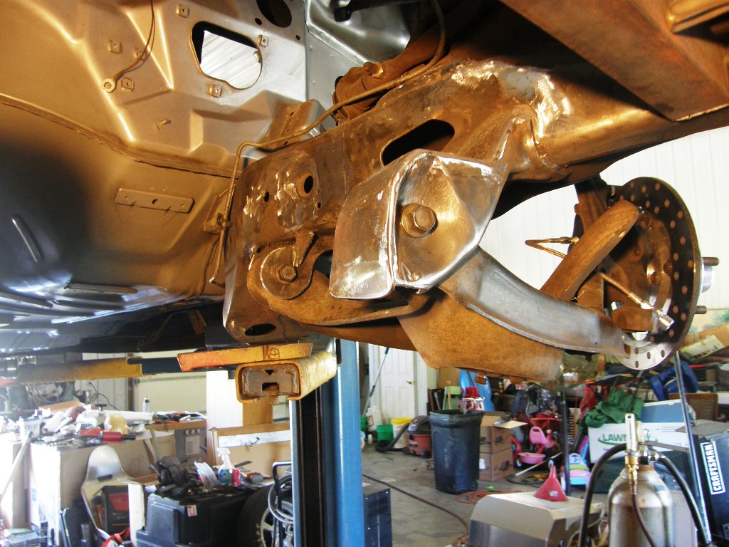

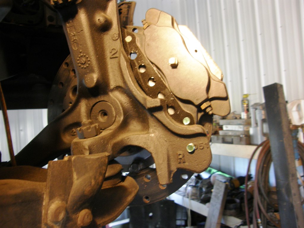

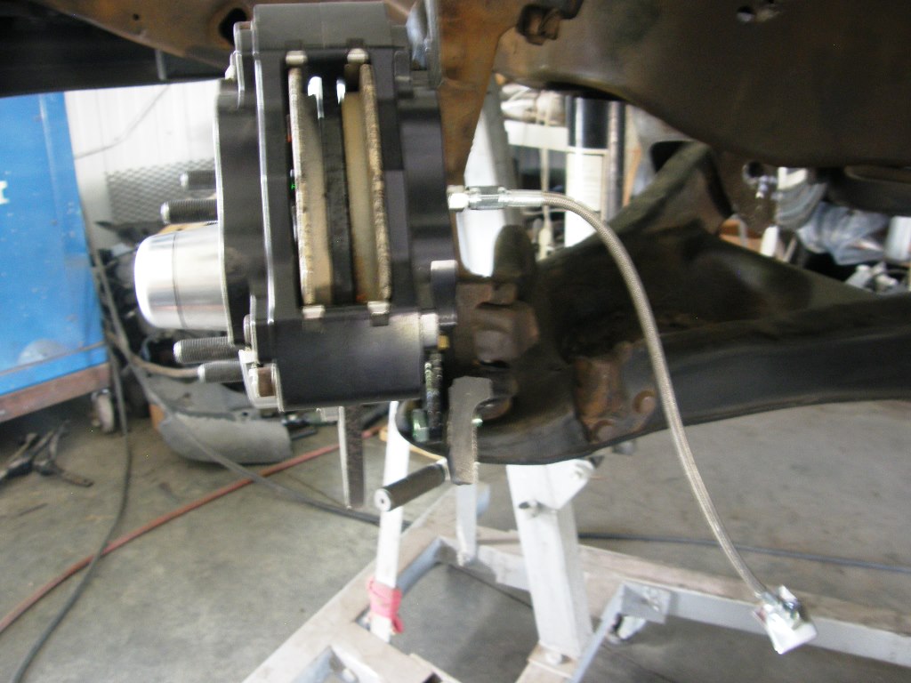

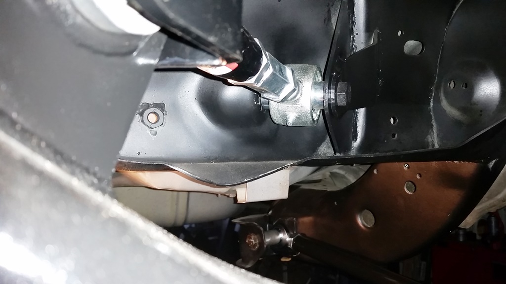

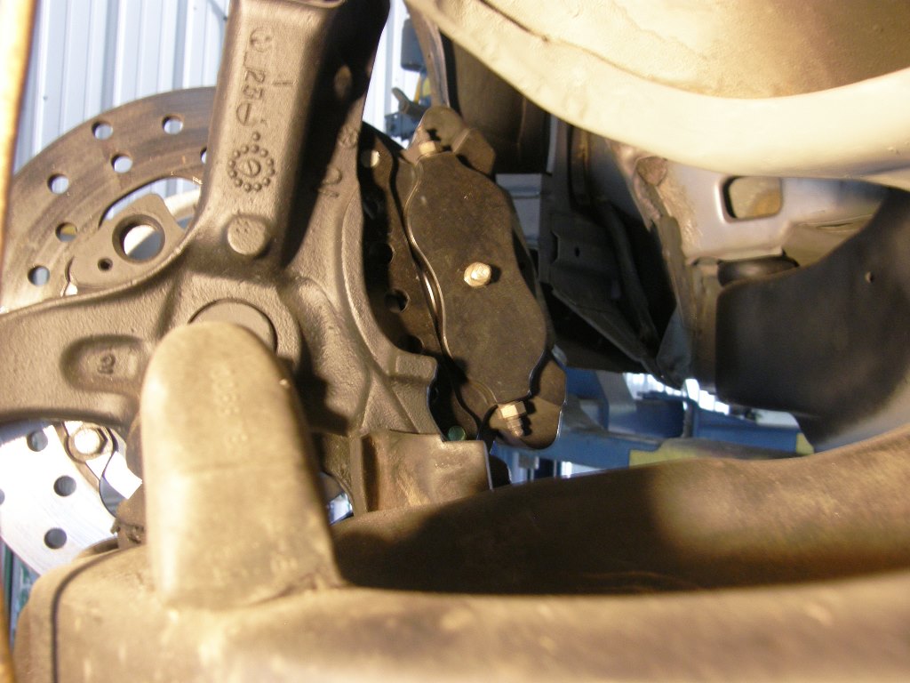

Since I have never raced one of these bodies, I didn't know if any of that rear suspension would give up. I took the liberty to making some reinforcement before I broke it. I knew my engine produced smaller amount of torque with a 3" stroke, so I wasn't that concerned about ripping it out.

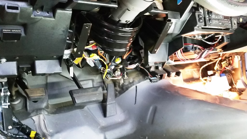

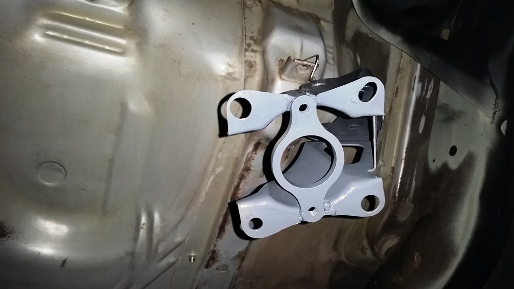

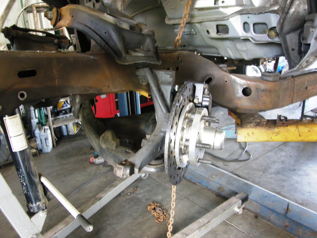

I used brake kit for an 82-92 Camaro and made the mount bracket to meet the dust shield mounting holes. I enlarged them to 3/8". Of course had to cut off the stock mounting as well.
Brake pedal mount modification was needed to achieve the recommended brake pedal ratio and rod alignment. I went ahead and incorporated the master cylinder mount, for ease of replacement.
Ernie Neal
SS 354
Oh sorry these pictures are not in chronological order

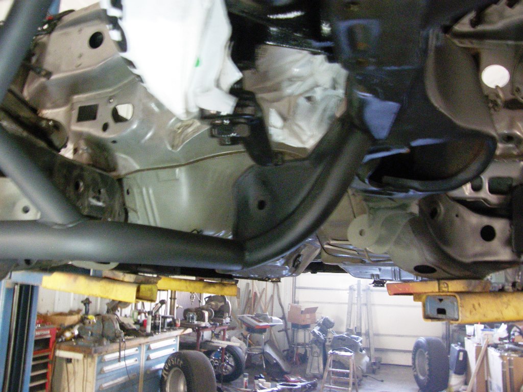

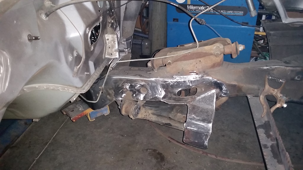

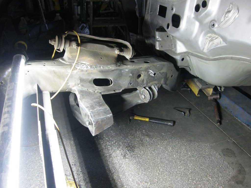

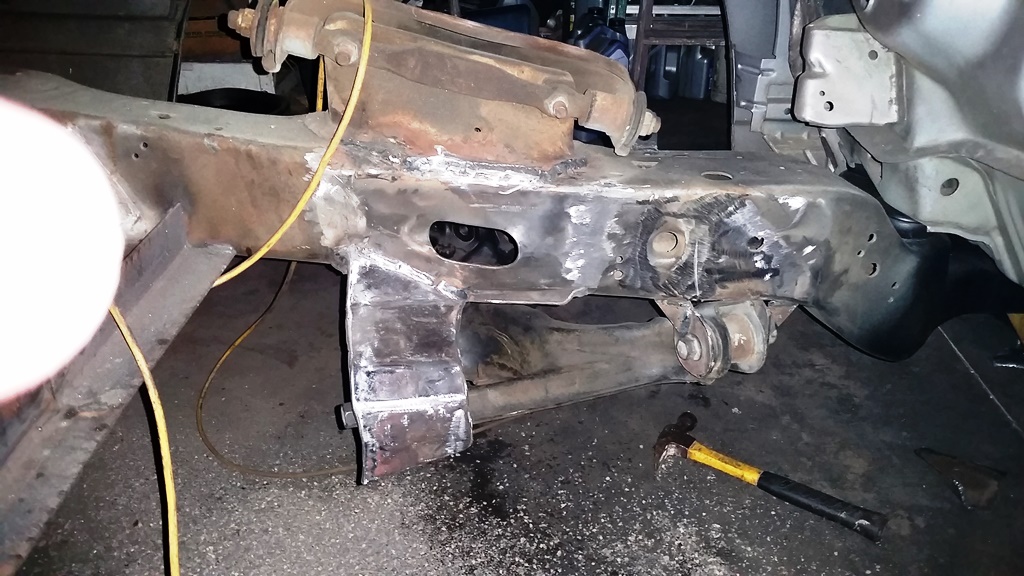

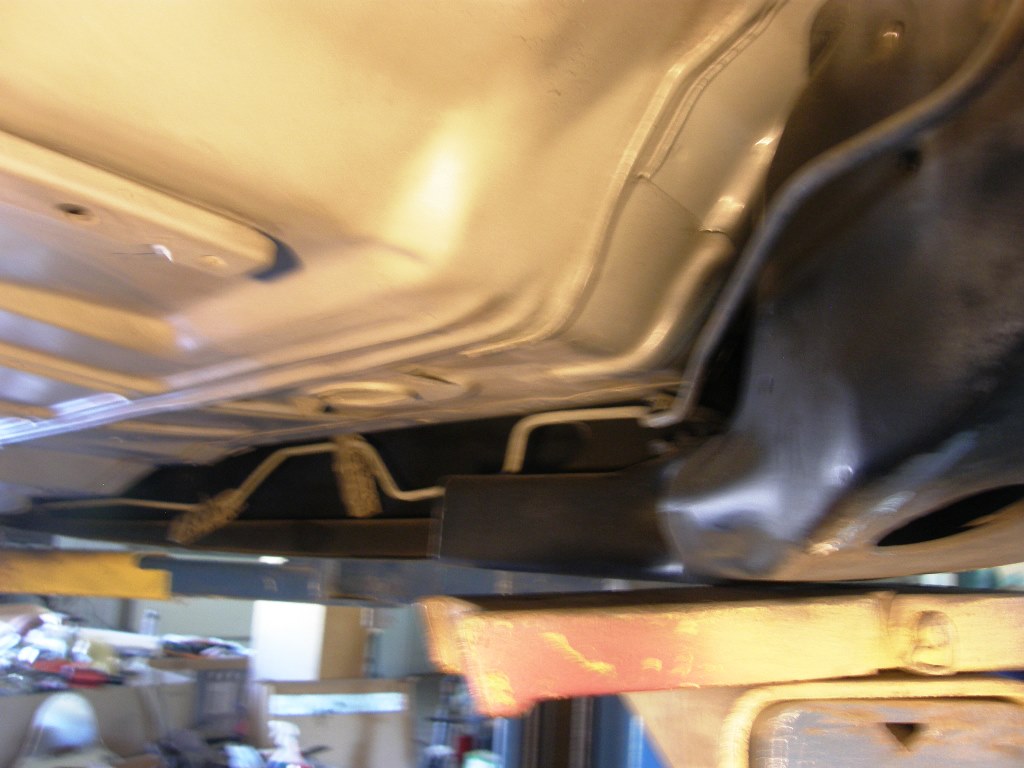

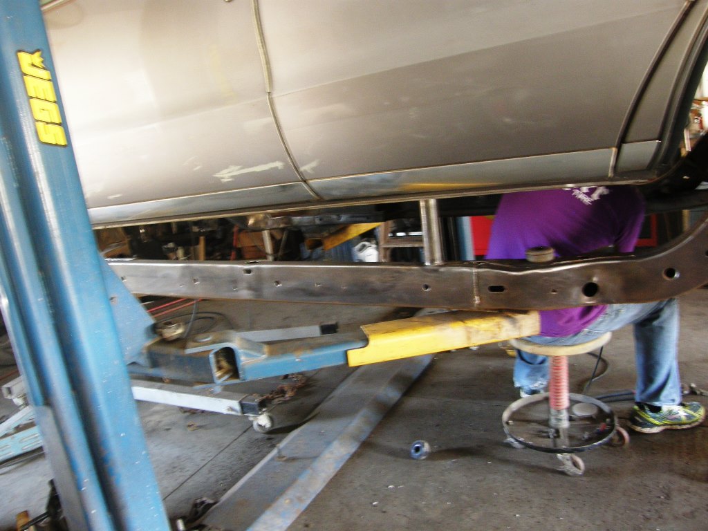

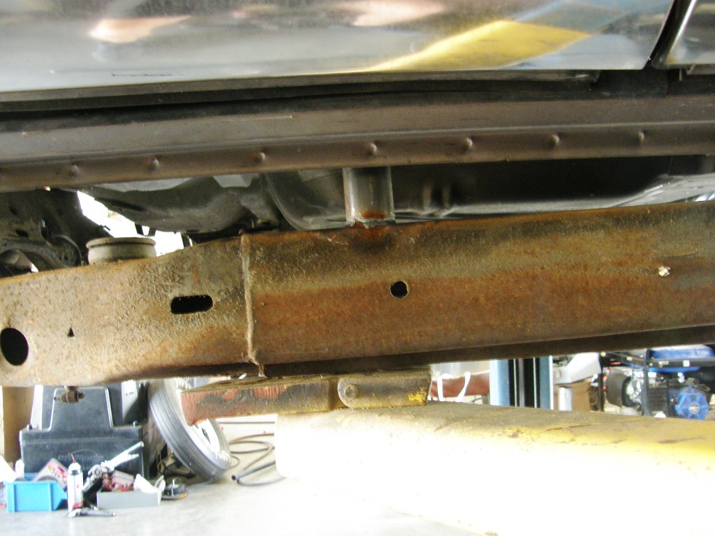

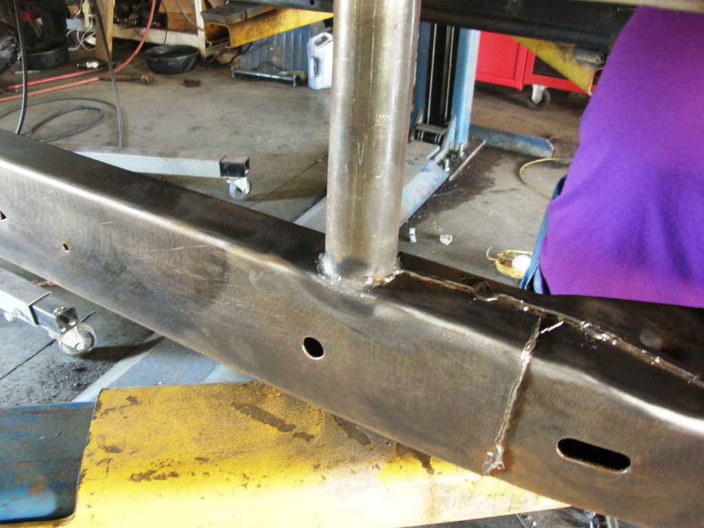

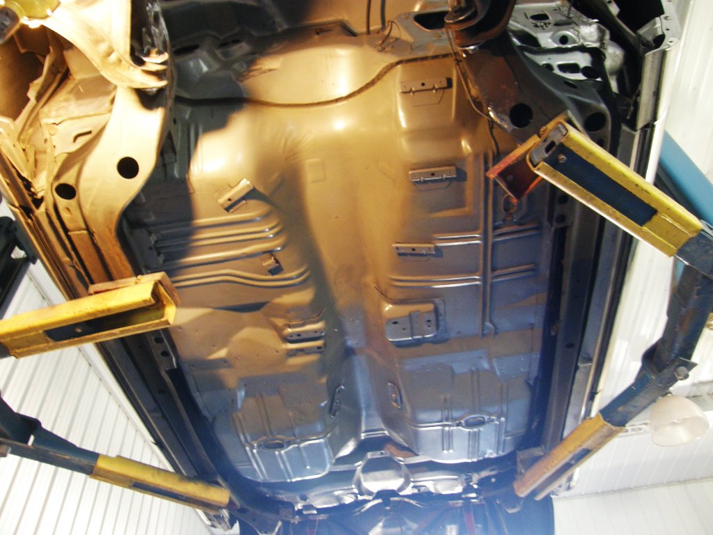

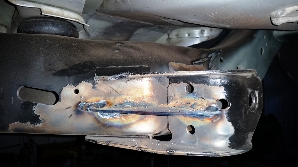

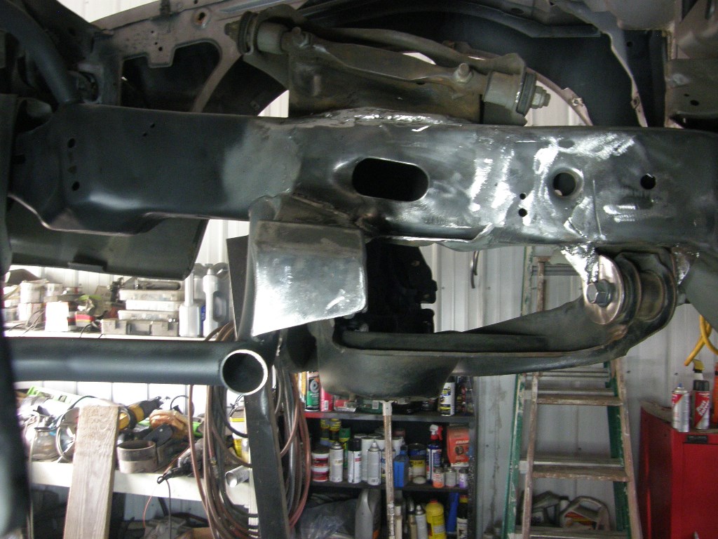

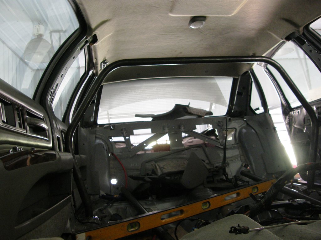

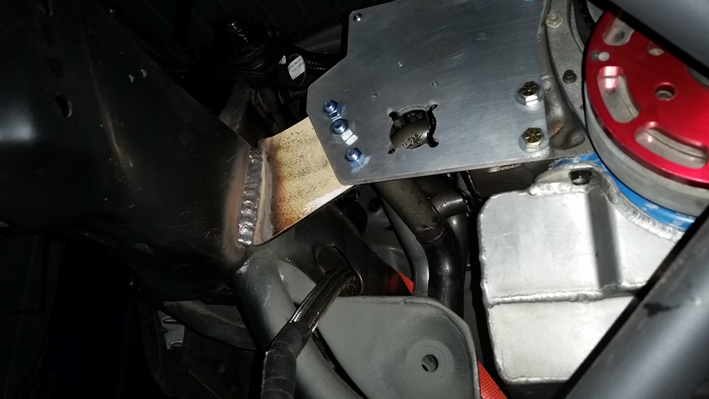

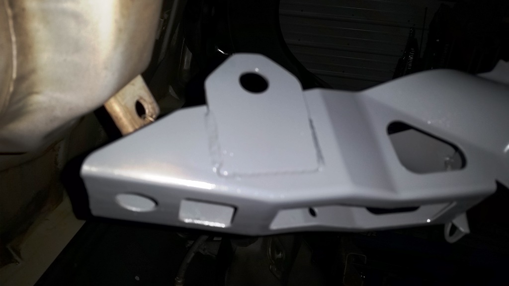

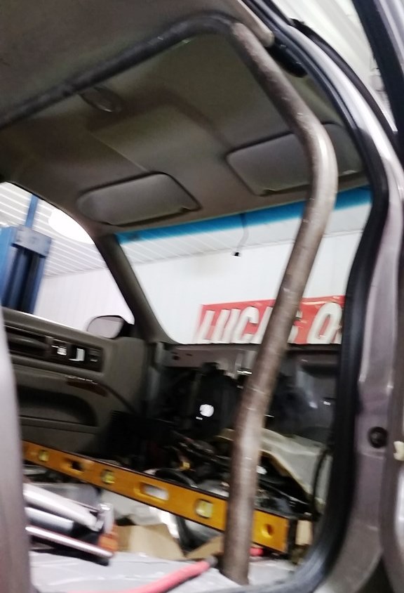

plated the lower A frame mount after cutting out the factory crossmember for oil pan clearance
some rollbar fab work

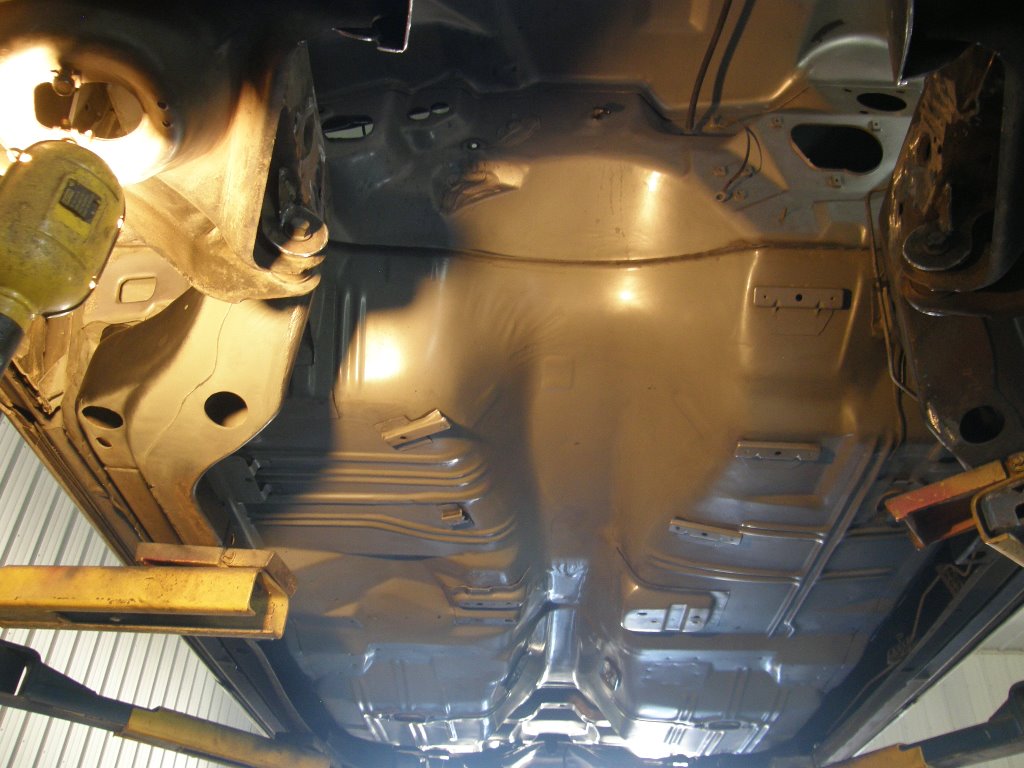

cleaning and wire brushing the frame while it was dropped down.
the bottom of this car is really nice for a 96
Happy Thanksgiving to all
ID:	52647   Click image for larger version
ID:	52648   Click image for larger version
Name:	pan clear right.jpg
ID:	52650   Click image for larger version
Name:	right rear bar.jpg
ID:	52651   Click image for larger version
Name:	rollbar support hole.jpg
Name:	start of frame clean.jpg
ID:	52653   Click image for larger version
Name:	painted some of bar now.jpg
ID:	52654   Click image for larger version

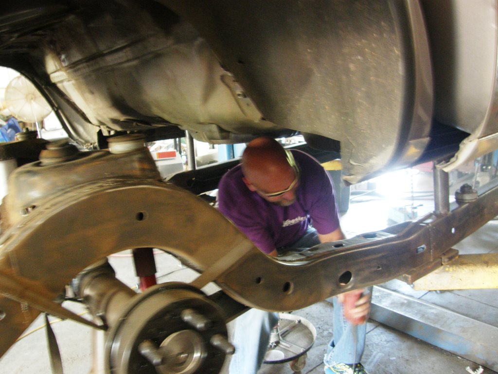

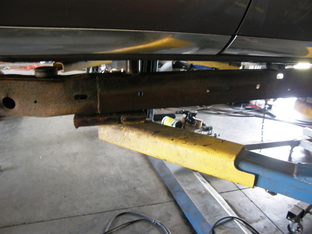

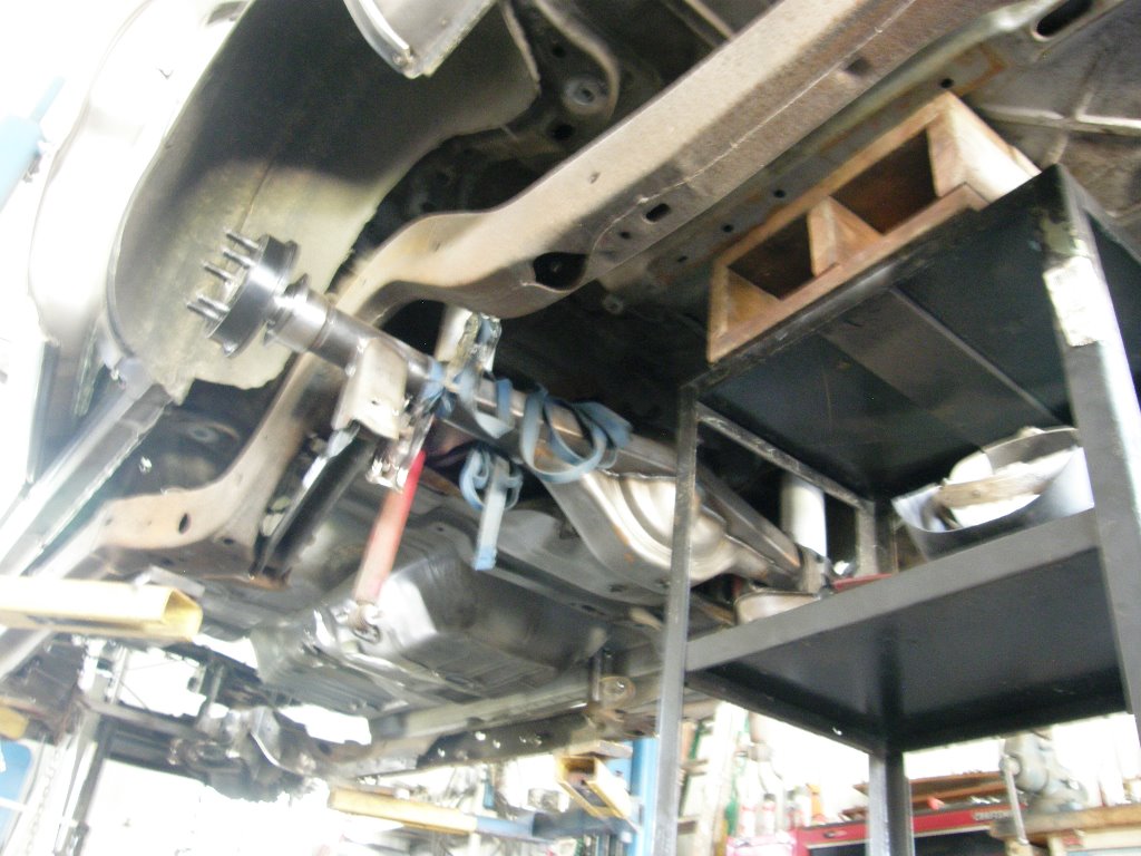

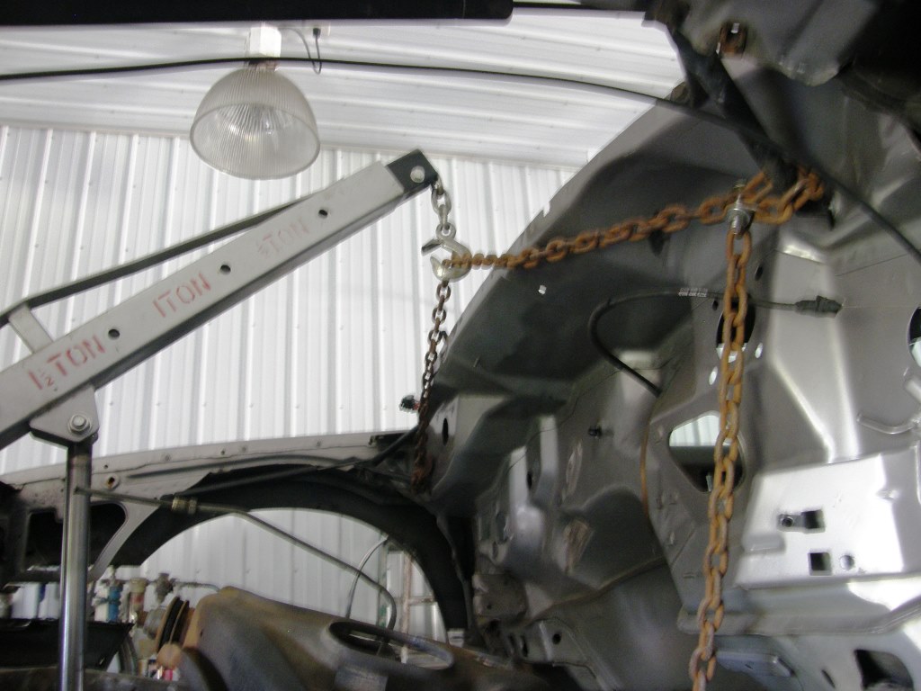

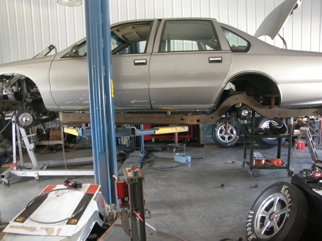

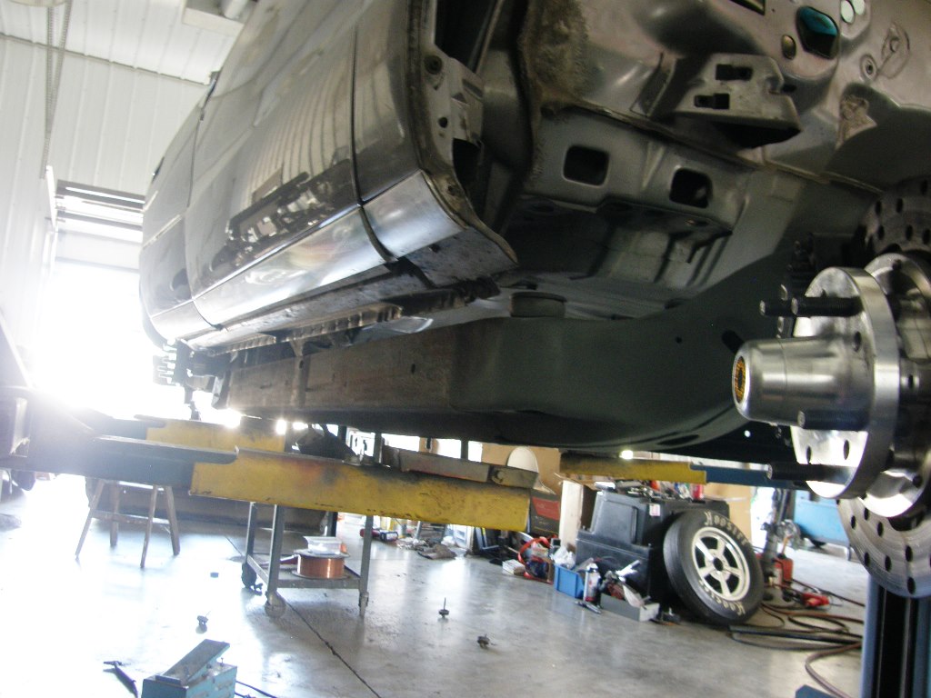

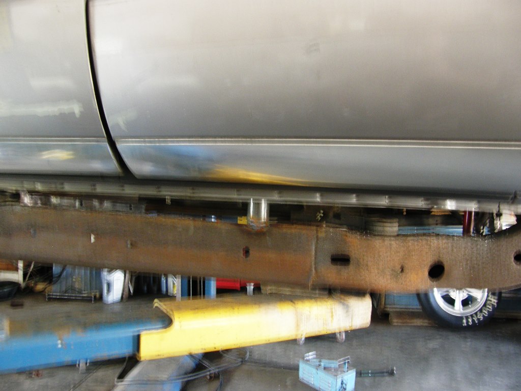

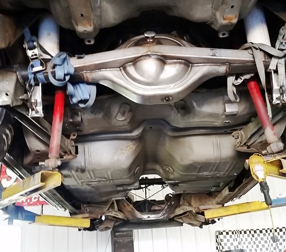

Had to get a little creative with the cherry picker and a roll-around cart to support the body while we were cleaning, rollbar installing and painting the frame.
Hope you can make it out via the pictures

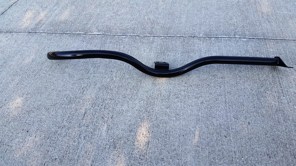

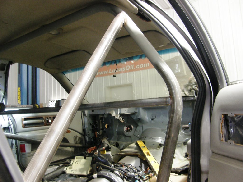

Ernie II and I worked with grinders and cup brushes to get the frame ready for some paint.
I got to tell you guys, while we were both using those cup brushes, my son went out to get in his truck, when he got in he yelled out. He came back into the garage to find out ole' dad had stuck with one of the wires, ouch. I laughed, but he didn't think it was to funny.
Still more to come

Name:	body suspended 2.jpg
ID:	52663   Click image for larger version
Name:	body suspended.jpg
ID:	52664   Click image for larger version
Name:	cherry picker suspension.jpg

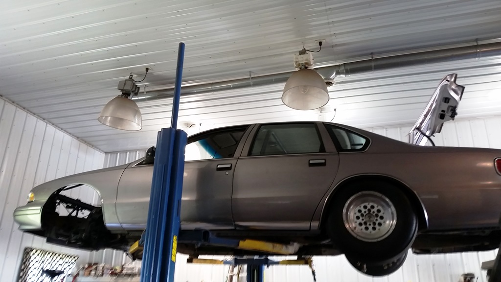

ID:	52669   Click image for larger version
ID:	52670   Click image for larger version

Larry,
I think I swept up about three dust pans full. Everything in the shop covered. I think I am still blowing it out of my nose.

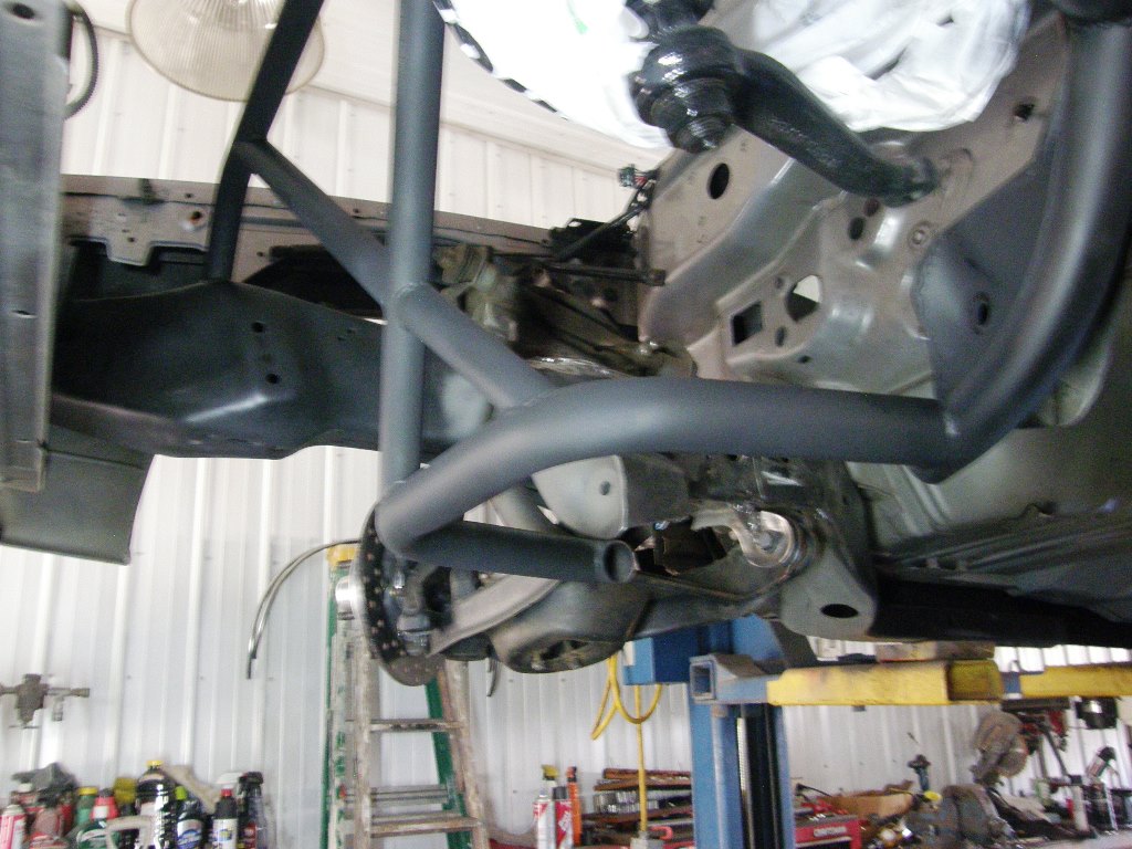

More bottom photos

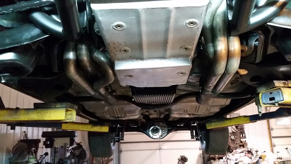

Rollbar work along with front crossmember cut out for oil pan clearance and plating area where metal was removed.
Ernie

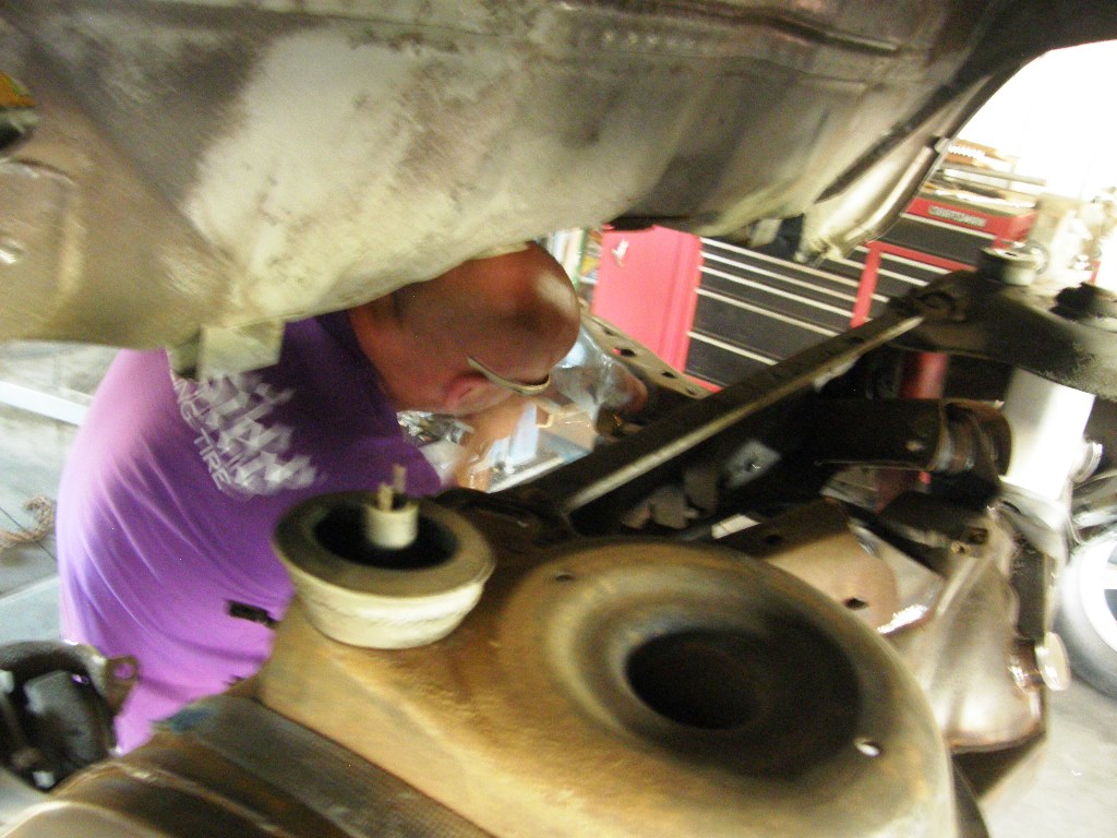

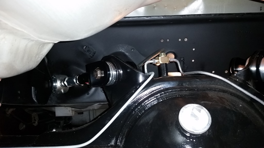

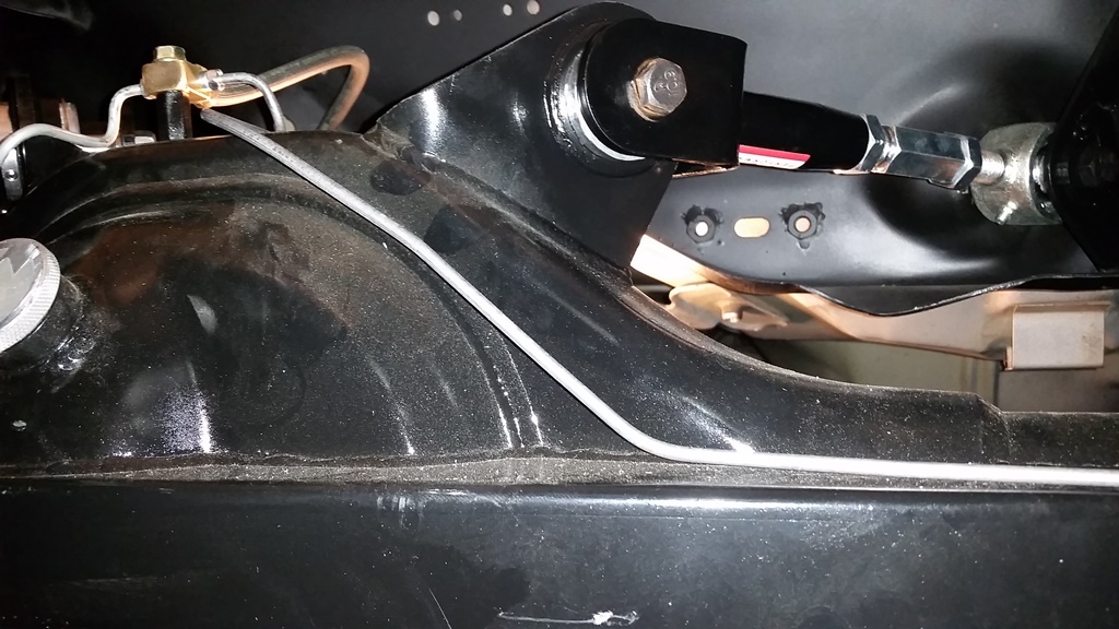

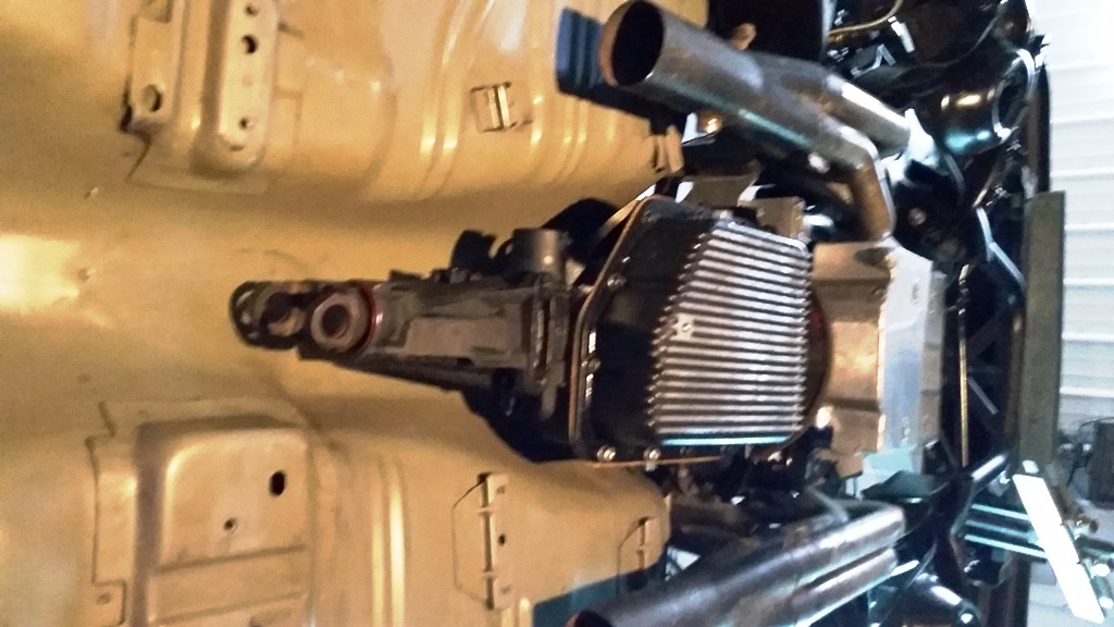

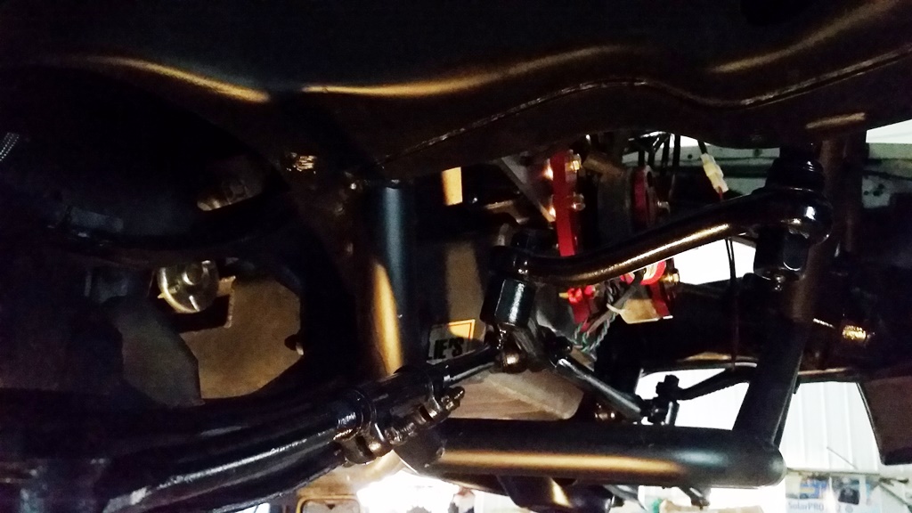

My son (Ernie II) is working on a startup video and pictures, I will post it too
Work on the left front caliper mount

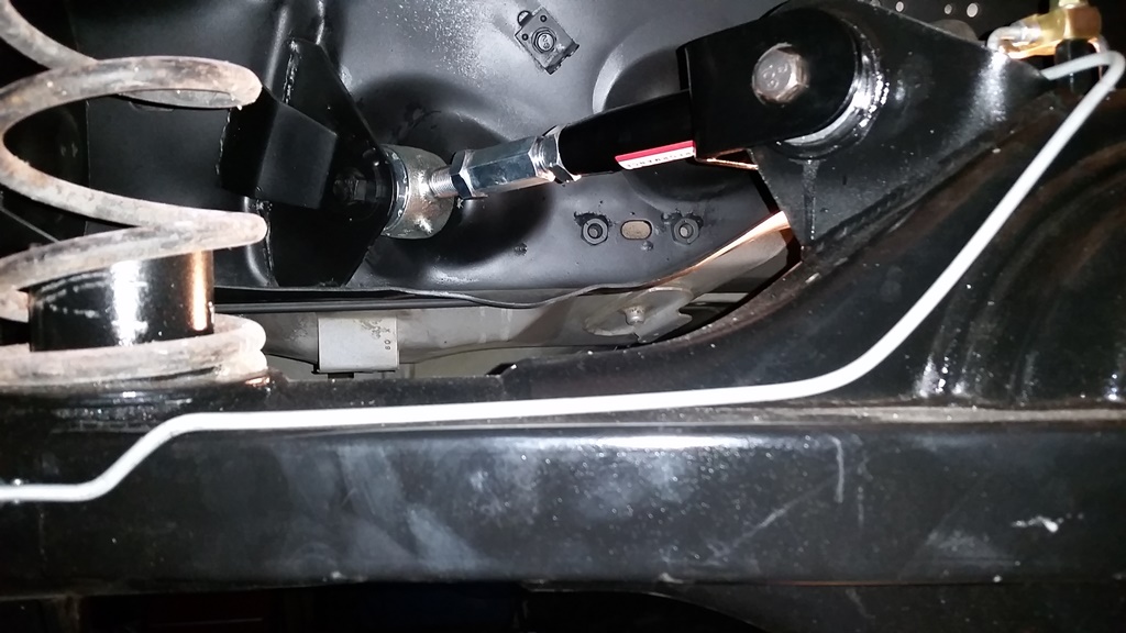

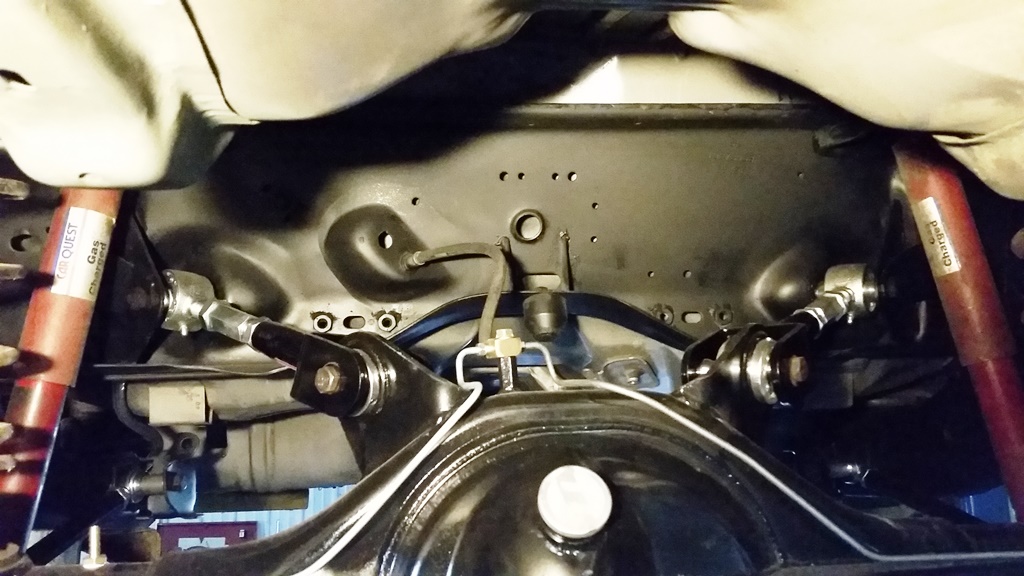

Spohn upper arms on the back
Brake line plumbing

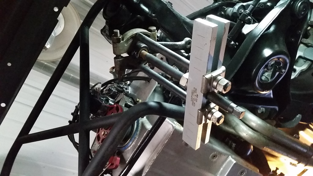

Didn't have a pitman arm puller, but this bearing puller worked.

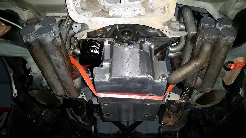

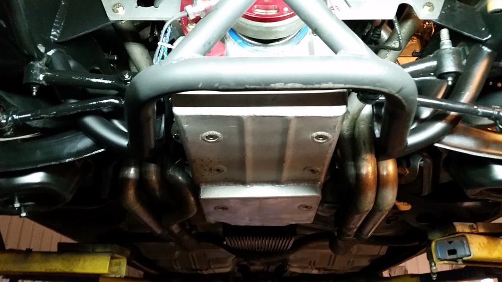

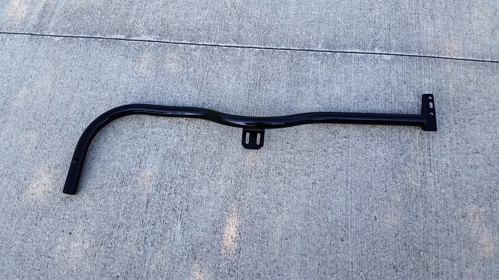

I added these bars to strengthen what I had cut out and reinforced for oil pan. I didn't want any frame flex. The lower bars are 1 5/8" chrome moly and 1 1/4" on X and top. I didn't want to motorplate to be overloaded.
Stay tuned

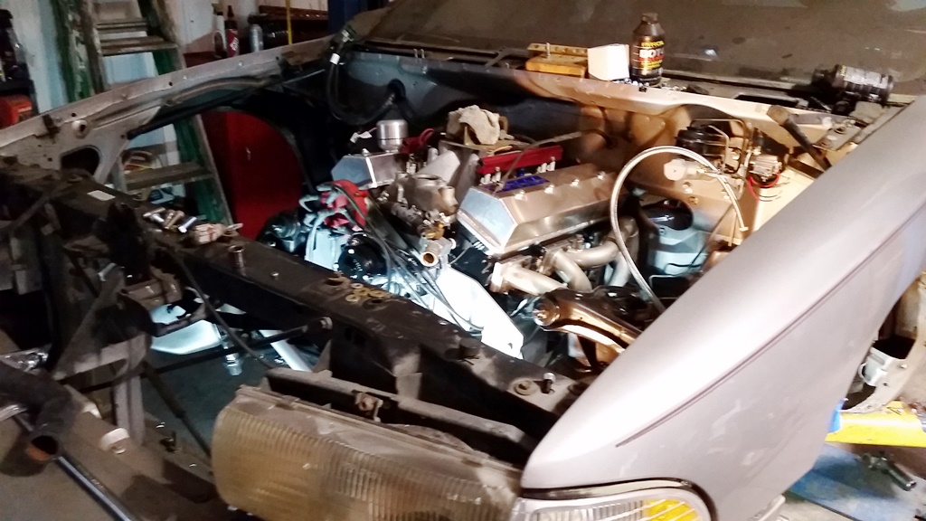

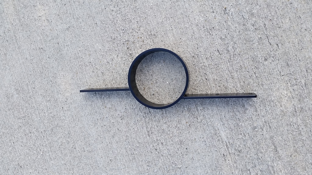

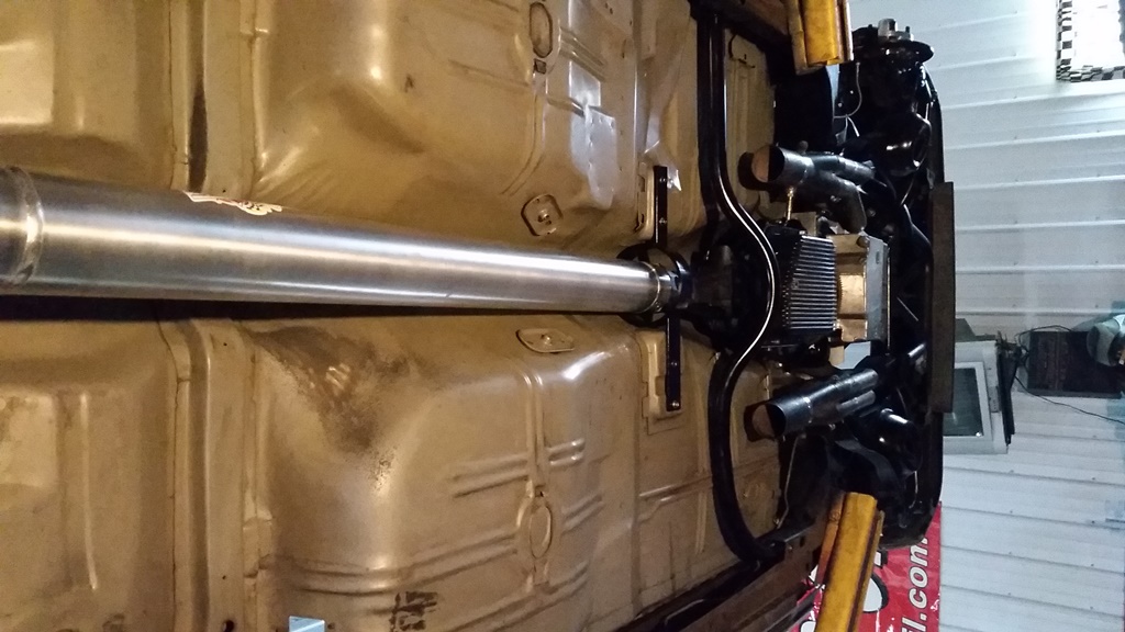

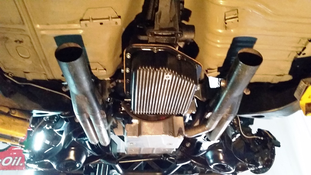

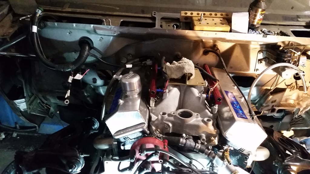

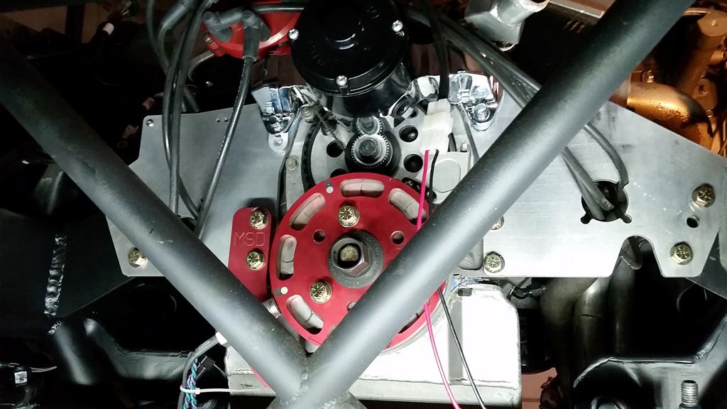

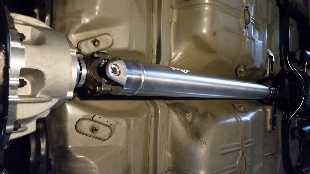

Just a few more

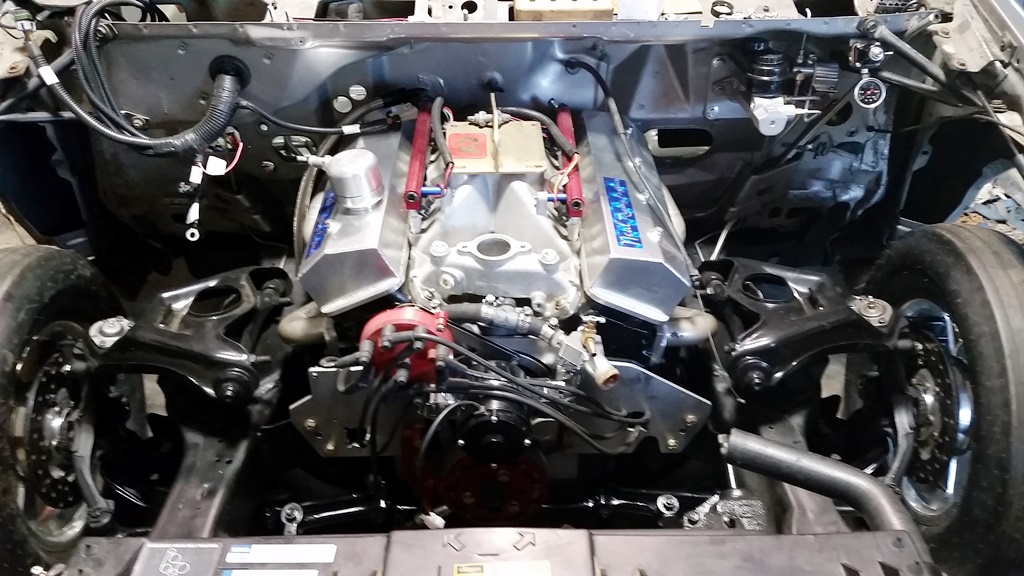

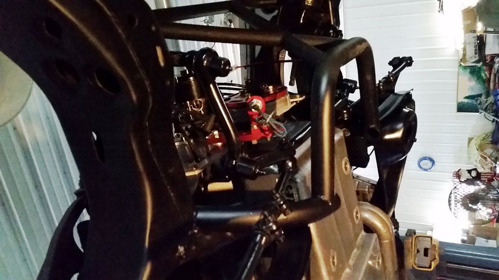

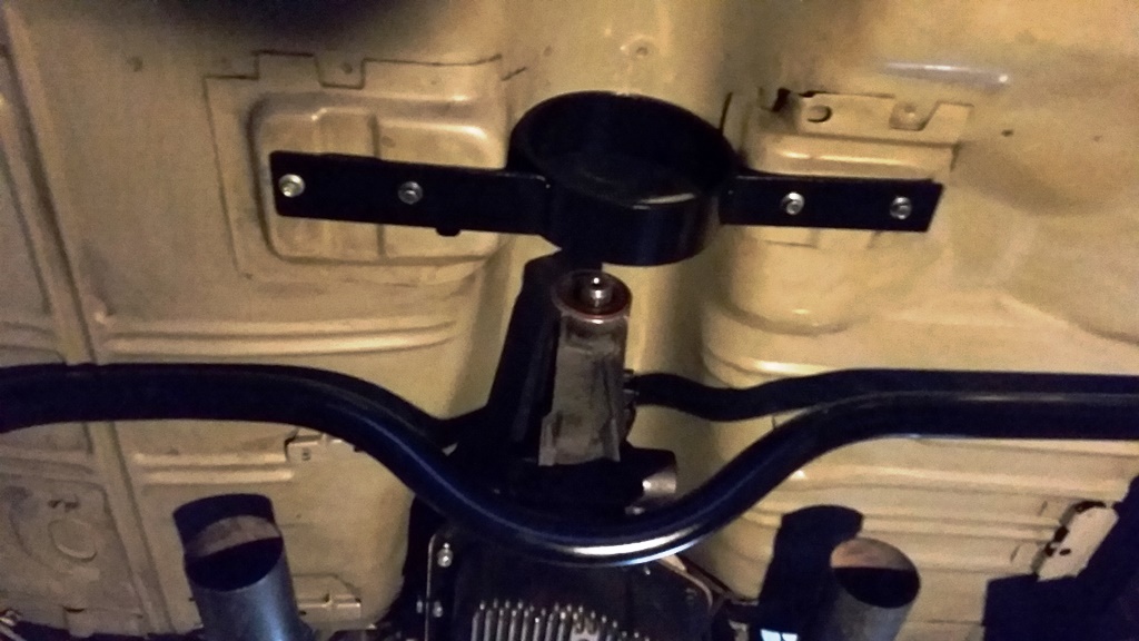

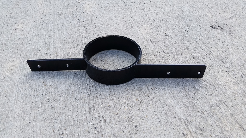

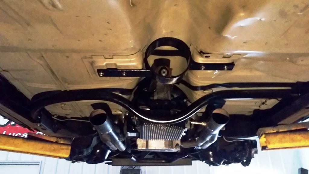

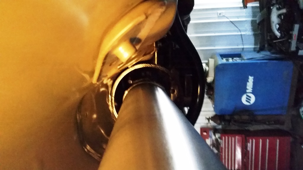

Photos of driveshaft and loop in place. The crossmember installed. Engine just hanging there with straps. Riner transmission installed.
Engine bay photos
ID:	52726   Click image for larger version
ID:	52727   Click image for larger version
Name:	engine and trans mounted.jpg

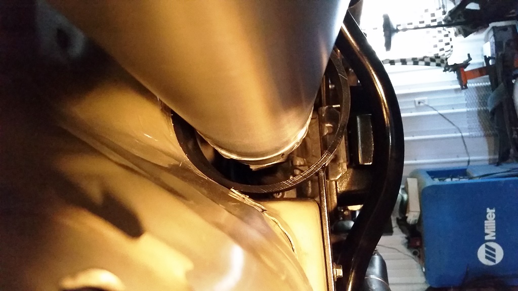

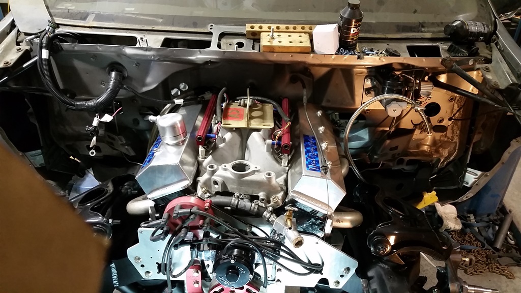

photos of engine bay, Larry Wilson's Chevelle headers, oil pan clearance and front engine motorplate mounting bracket
Ernie Neal

Name:	Chevelle headers fit.jpg
ID:	52734   Click image for larger version
Name:	engine bay later.jpg
ID:	52735   Click image for larger version

Old 12-15-2019, 01:05 PM   #10
Ernie Neal
Ernie Neal's Avatar
Join Date: Feb 2009
Location: Columbus, Indiana
Posts: 533
Likes: 173
Liked 328 Times in 80 Posts
Default Re: 1996 B Body Caprice for Superstock
photos of driveshaft loop and crossmember, plus underside of car
Ernie Neal
SS 354
Name:	driveshaft loop heavy.jpg
ID:	52741   Click image for larger version
Name:	driveshaft loop installed.jpg
ID:	52742   Click image for larger version
ID:	52744   Click image for larger version
Name:	ds loop installed.jpg
ID:	52745   Click image for larger version
Name:	moly crossmember.jpg
Name:	moly xmember.jpg
ID:	52747   Click image for larger version
