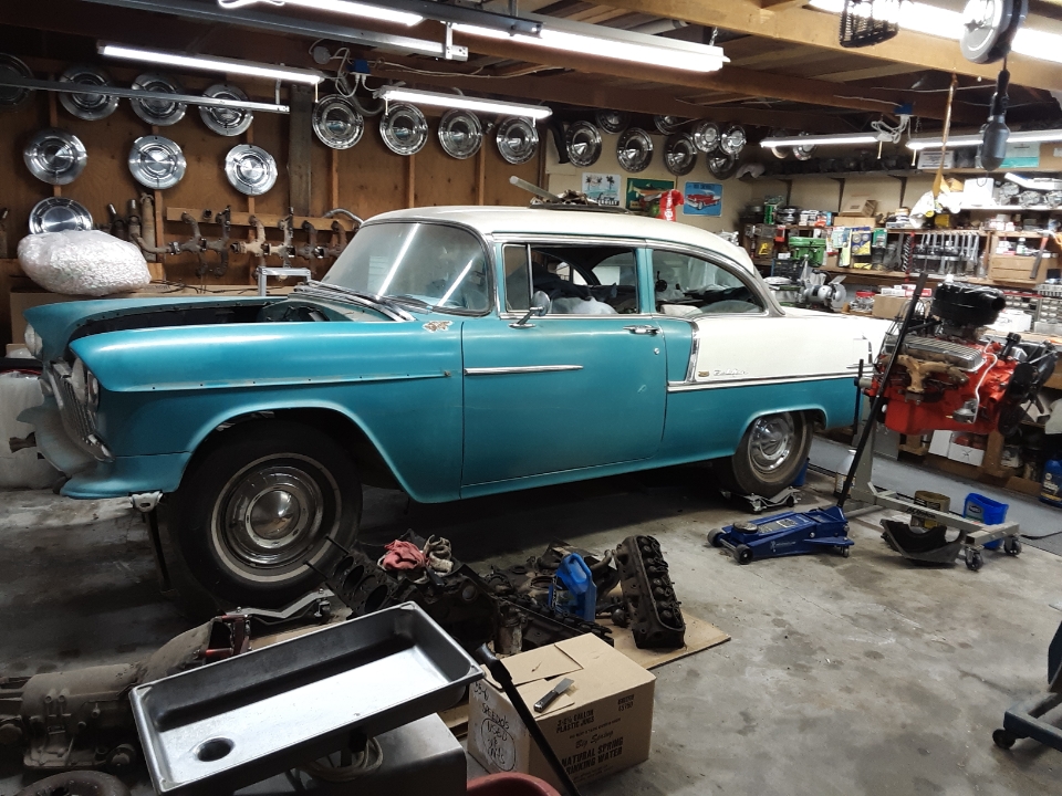

Here are a few shots of the car from purchase to now.
