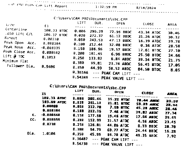

I don't design cams. I do look at Cam Dr / Audie data. In this video Daniel Powell talks about .00033 as about max acceleration and the problem with this cam other than the noise is .00038 max acceleration.I don't own an Audie system. I do have a report from someone's Audie system for a BTR Stage 2 cam which shows Peak Open Acc. 0.000379. What have others seen?
Stan
This is a poor screen capture of the Erson cam that Eric used with his LS Cam Challenge engine . Which shows Peak Open Acc. 0.000384
Last edited by Stan Weiss; 01-03-2025 at 12:30 PM. Reason: Added Audie Report for Erson Cam

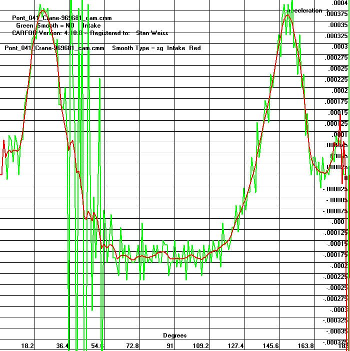

I do have some old CamDr files, but I always look at them in crank degrees / numbers. I just changed this one, a Crane Blueprint version of the Pontiac Ram Air IV cam so that I could do cam numbers like Audie. The raw data has a huge amount of noise, but I was surprised at the Peak Opening Acceleration for a cam this old.
Stan

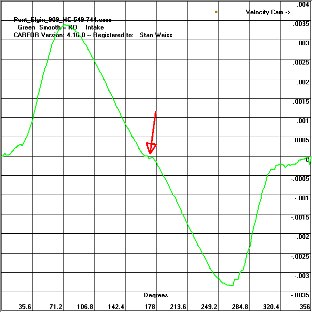

One of the things that is done on stocker cams is having the valve "dwell" at max lift. This is a velocity curve from an aftermarket manufacture, for what is called an exact copy of the Pontiac 744 cam. This cam was used in production Pontiac cars. You can tell a dwell cam because you have an area of horizontal / constant velocity over the nose. Does anyone know of any other OEM production cam that has dwell?
Stan
