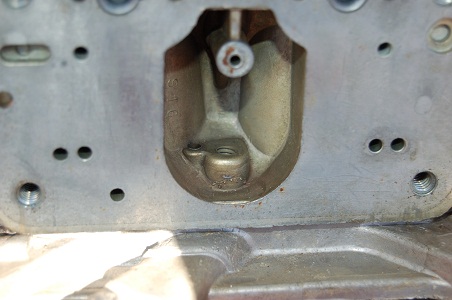

I have a 750 Holley that has developed a leak through the base of the carb. Fuel is running out though a hole in the base, beside the base screw. This hole goes up into the area behind the power valve. I have change the power valve and changed the power valve gasket and when the fuel goes into the fuel bowl then fuel start to run out this hole. Any idea how to fix this?
Added a photo. This is the front, primary. of the carb. The cavity is where the backside of the metering block, with head of power valve goes. The hole to the right is threaded and is where one of the base plate screws go in. The hole to the left is where the fuel is running through and coming out the base of the carb.

Next to the middle-front base plate screw?
That sounds like the passage that sometimes has an anti-backfire valve to protect power valves from blow-out. If it's not the power valve or its gasket leaking, only other things I can think of is the metering block gasket or casting issue. Double-check the metering block & main body gasket surfaces for any debris. Wouldn't hurt to check for casting warpage, but I've never seen that problem come up.
Myron Piatek is offline   Reply With Quote

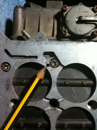

Is this the hole you're talking about, Chris?
It's the vacuum port for the power-valve, so I'd make sure the valve and gasket were good. The metering block itself could have a bad gasket but I agree with Myron that it's unlikely to be warped badly enough to leak.
I also think that the later model Holley's were modified with a o-ringed transfer tube for the accelerator pump shot through the metering block and of course the gasket was changed to accommodate it. If you use that gasket with the older metering block you'll get a leak for sure!
Good Luck finding the problem!

Lew, that is exactly where the fuel is running out of the base. I am going to change all of the gaskets, put a power valve block off plug in the metering block instead of a power valve and see what happens. I've never seen this either thanks for the help.
