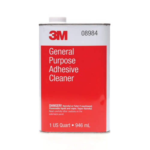

This is the best adhesive remover I have ever used and it is easy on paint. It works great for removing rubber and black specks from the burnout box too.
