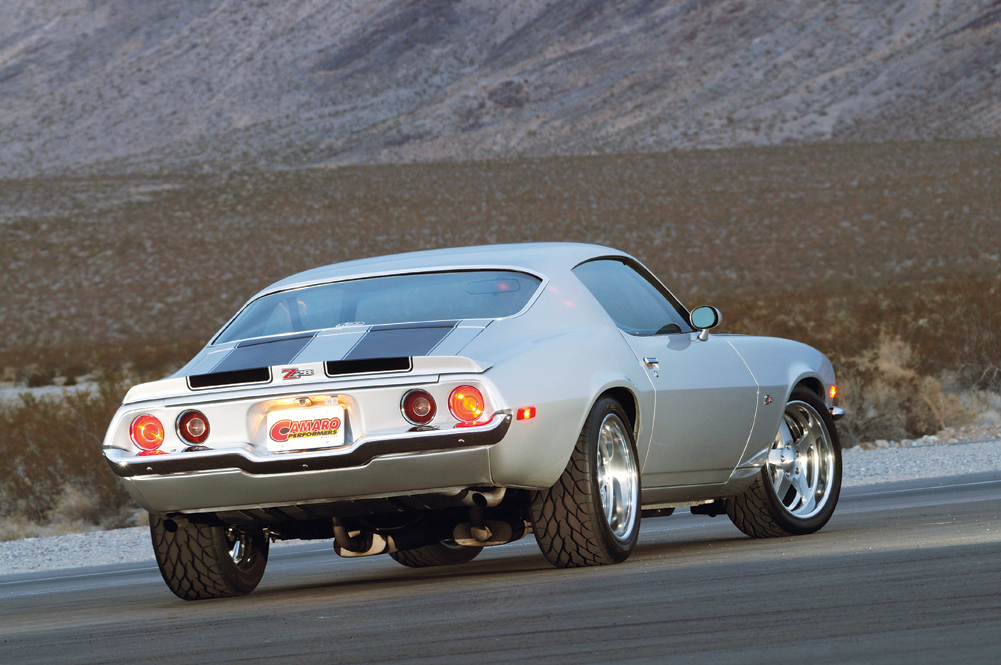

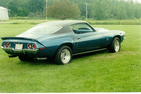

This is what I recall, the deck lid model.
The spoiler on this Camaro is this Pontiac Trans Am one with the rounded end caps. I have never seen a Camaro with the TA rear spoiler on it from the factory.
I thought the "blade" model was Camaro only.
Bobby; while I can only offer my opinion, I've had quite a few of these cars and have learned a thing or two about them over the years. I've never heard of a 2nd Gen Camaro that ever had the Firebird rounded 3 piece rear spoiler factory installed. The only spoiler that should be on there is either the low 1 piece or the straight edged 3 piece that you've mentioned.
I suspect that the car you're looking at had the wrong spoiler installed by a previous owner, or by the dealership at a customer's request, and the story you were told by the current owner was dreamed up to "legitimize" it. If you do buy that car and don't change it to a Camaro spoiler be prepared to be debating it being there with every Camaro guy that sees it! LOL

I had to read your post a couple of times before I saw that basically you said what I said....the rounded Firebird end caps were not used on a Camaro. The center piece of the spoiler is the same whether it was used on the Camaro or the Firebird. I never mentioned that because I figured Bobby was more interested in whether the rounded ends were correct on Camaros.
And you're right about the low spoiler also being installed on early '71s. I had an early '71 Z/28 with the low spoiler, as well as two later '71s with the 3 piece spoiler.
