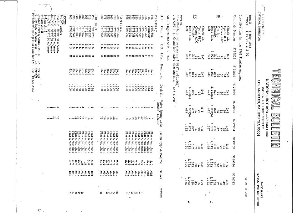

Just wondering if anyone has the old NHRA cam and spring specs for a 68 GTO 400/350 4 speed. I bought one to restore and thought it would be fun to build it around the old stocker specs.

NHRA has the lift specs but they don't have the duration and overlap specs which is what I'm looking for.

Cam number 9779067
Name:	1968 Pontiac cam specs.jpeg

SPECS FOR CAM # 9779067
INTAKE
Dur 273
CL 112
Rocker arm lift
1.5---.407
1.65--.447
OVERLAP 54
EXHAUST
Dur 289
CL 113
SAME ROCKER SPECS

Thanks guys that's what I was looking for.
