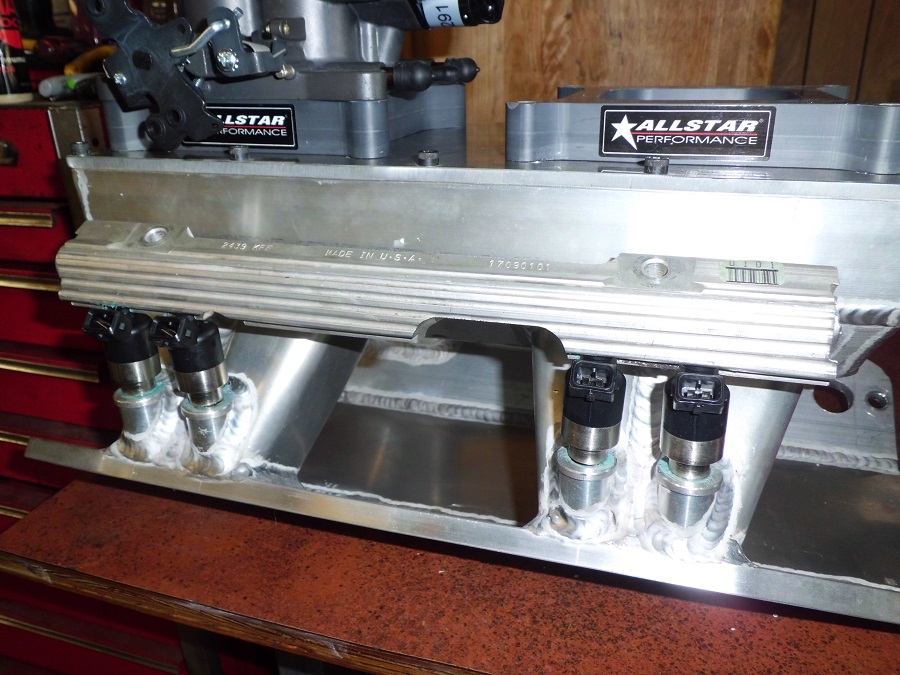

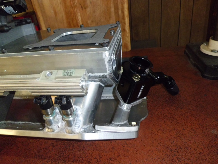

Default Re: SBC EFI fuel rails
this shows a factory fuel rail test fit. It does not have enough material to thread 3/8" pipe.

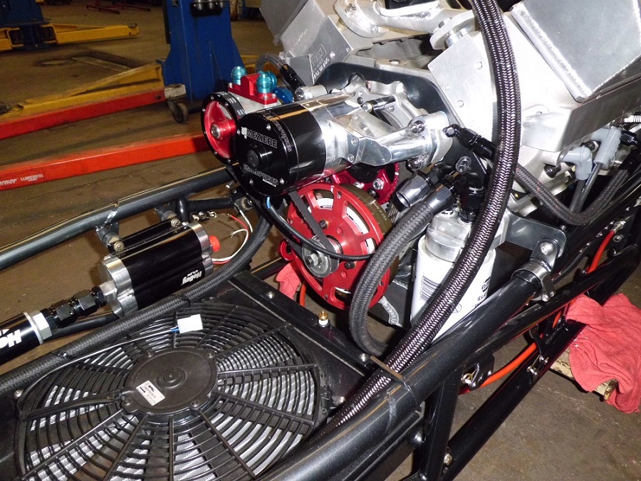

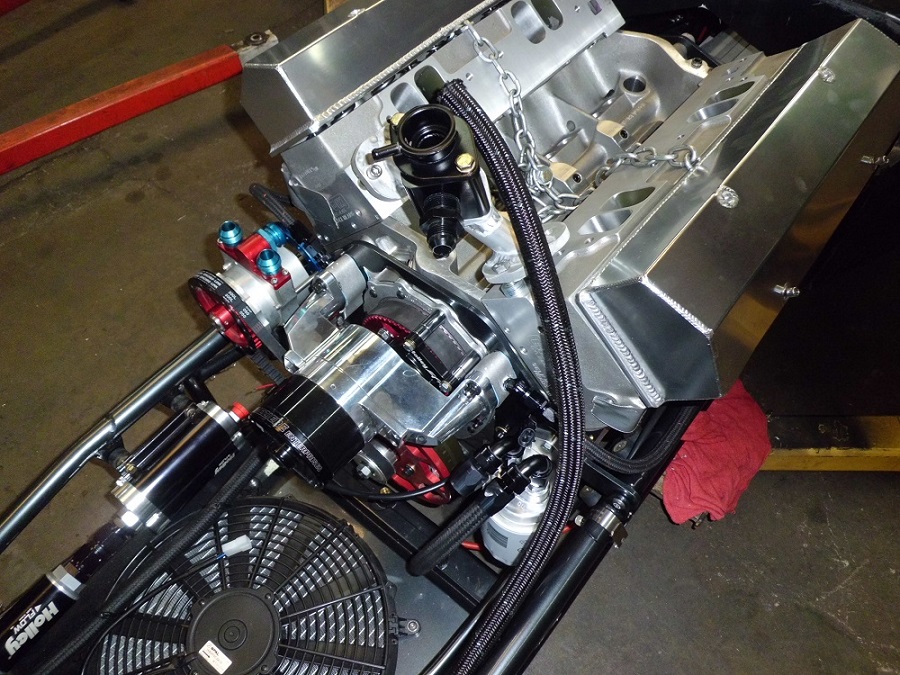

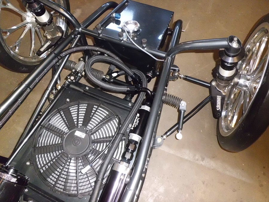

Ed,
it is our 417" SBC bracket engine.
Fuel cell, fuel filter, fuel pump, fuel regulator all #10
Holley EFI system
