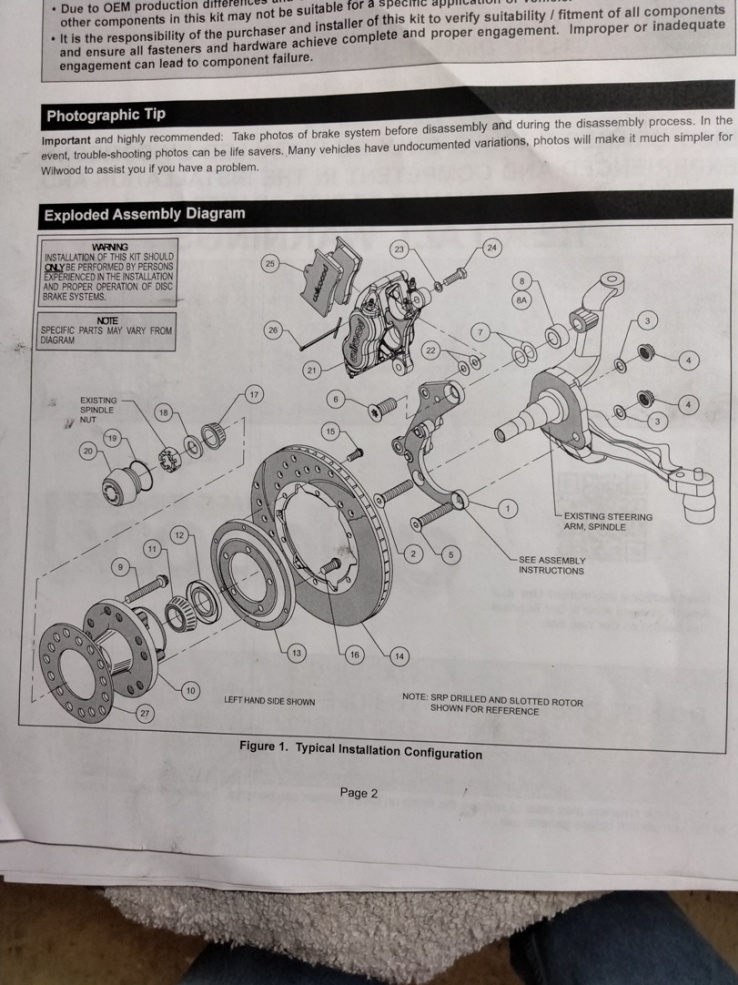

I'm in the process of changing the front discs on a 74 Corvette Bracket car from stock to a Wilwood setup. The upper bracket mount bolts to the stock spindle with a 11/16-16 Torx bolt (supplied from Wilwood). The bolt is 1 1/2 in long and needs to be torqued to 140ft-lbs. The problem is that when the bolt is spaced as per directions, there are 3 threads making contact in the hole. Not nearly enough for 140 ft-lbs!!
I'm waiting for Wilwood to return my call (hopefully they have a 2 or 2 1/4in bolt!).
In the meantime, anybody run into this and how did you handle it? Did you find a longer bolt? Where? (Grainger, etc don't have any that big).

Do you have the part number of the kit or a picture of the brakes assembled from the instructions? It would help us help you. I see what you mean 11/16-16 bolts are almost impossible to find online. Ray

Wilwood 140-12040 Brake kit for 69-82 Corvette Front. #6 on the blow-up pic. McMaster-Carr has bolts that are close (hex-head 3/4-16), but would need to drill and thread the hole. A bit much for a 'Bolt-in' kit!

Are bolts 2 and 5 in the blue print look like there long ? Would they work if they shipped you a Qty of 2 ? ... I see they are differant after looking closer , top bolts are 11/16-16 & really hard to find hope they can help you they just overlooked that detail .
