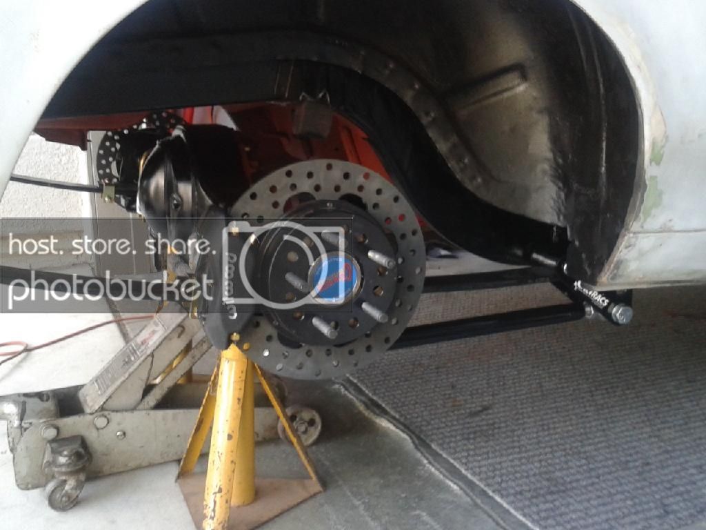

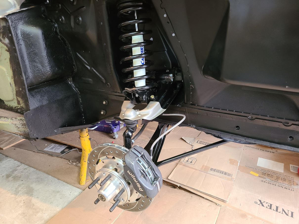

I used some Wilwoods on my '68 mostly because I found a good used set of street brakes for the front that I wanted in case I put the car back on the road. I used drag race brakes for the rear and their master cylinder.
