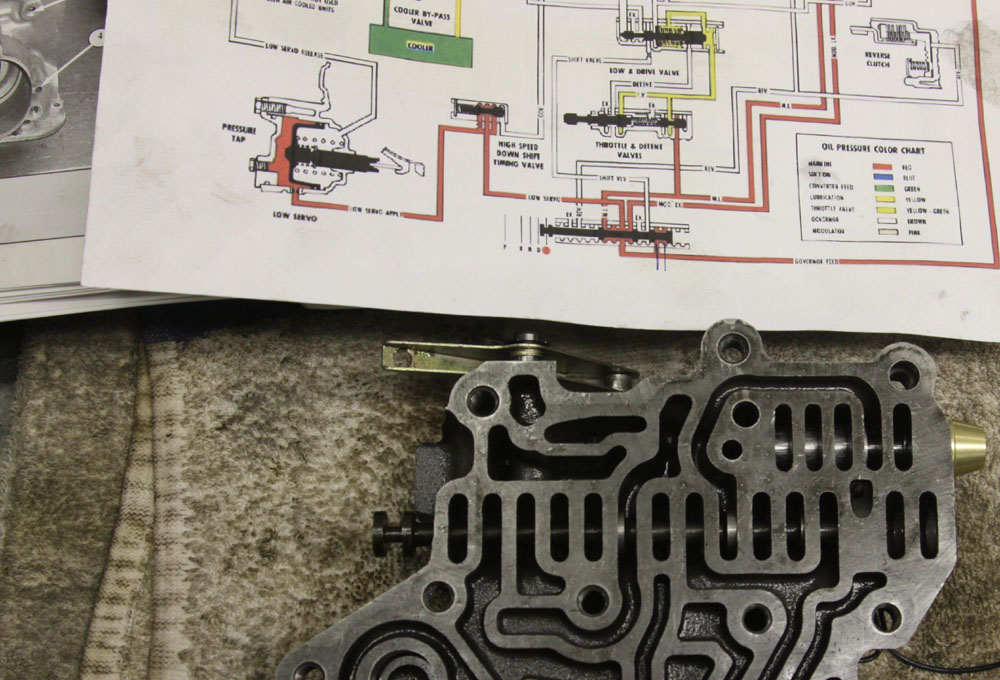

So then I decided to tear into the valve body (ATI #203300) and take a close look at everything there, suspecting an internal problem. Everything looked ok in there with one exception.. The manual spool valve seemed to not line up properly with all the lands in the body as I moved it into each gear position. I had bought a new manual valve from ATI a week earlier figuring I would change it out as well, if perhaps mine was worn in diameter and causing leakage....
Well what I found is that my manual spool valve had two of the spools in a roughly 1/8" different position than the new spool valve, as well as one spool which was narrower. See the attached pic below of the comparison. When I put the new spool valve in the body, each spool lined up perfectly with each land in the body.
Further analysis of each position, and each port showed that in Low gear, only 1/16" of the low apply port was being connected to line pressure. Likewise in high gear the same problem was present. depending on ever so slight slop, it could have even been worse, as well as causing leakage from each port into another, or to exhaust...
I never would have thought of this. I assumed all powerglide manual spool valves were identical. Most folks I talked to did as well. I don't know where that spool valve came from, and what the heck could be the history of it, but I know realize I have had all these problems since installing that valve body, and this was the cause.
So moral to the story, if you build glides, have several manual valves on hand, compare them and make sure they are all the same, and that they line up well with each land in the valve body.
The car picked up .2 and 3 MPH, shifted like a raped ape, and ran four passes within .01 of each other. And the fluid is as perfect as when I poured it out of the bottle.
Sorry for the long post, but I don't want ANYONE to have to go through what I have gone through the past month, and its certainly a 'weird' one, so keep this in mind.
See pics below. 1st pic: both spools. 2nd pic, the old spool in 1st gear position. 3rd pic the new, correct spool in 1st gear position.

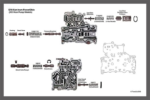

A long time ago I sold Trans King a big box of P/G parts I had collected.
There were about 11 V/B's in with all the other stuff. I did not get credit for two of the V/B's because he said they were older PG that had a rear pump. I questioned him and he said he couldn't use them because they were different. I just accepted it and went on. I can't remember if they were out of some old iron case PG's I had or the alum cased that had rear pumps. NOW!! I am wondering if the porting in the V/B was different. Could your Spool Valve be out of one of the older P/G's that could have had different porting??? Just wondering.
I'm not a PG expert on old parts by any streach!!
BTY: Where did you get those nice fluid diagrams in the pictures?? Nice!

I found it on the http://www.brianswayneonline.info/index.html
Swayne has the pictures of the non rear pump and the rear pump VB's and they are different.Check out the size, spacing difference of the passages around the spool valve area!!
I would bet the spool valve that goes with each is different. It is not shown... :~(
I will try to upload the picture. You can use that link and look around for the pictures is you like. well, another case of Al's internet paying off with info!! :~) Kevin, I'm just like you... didn't know that one!!
