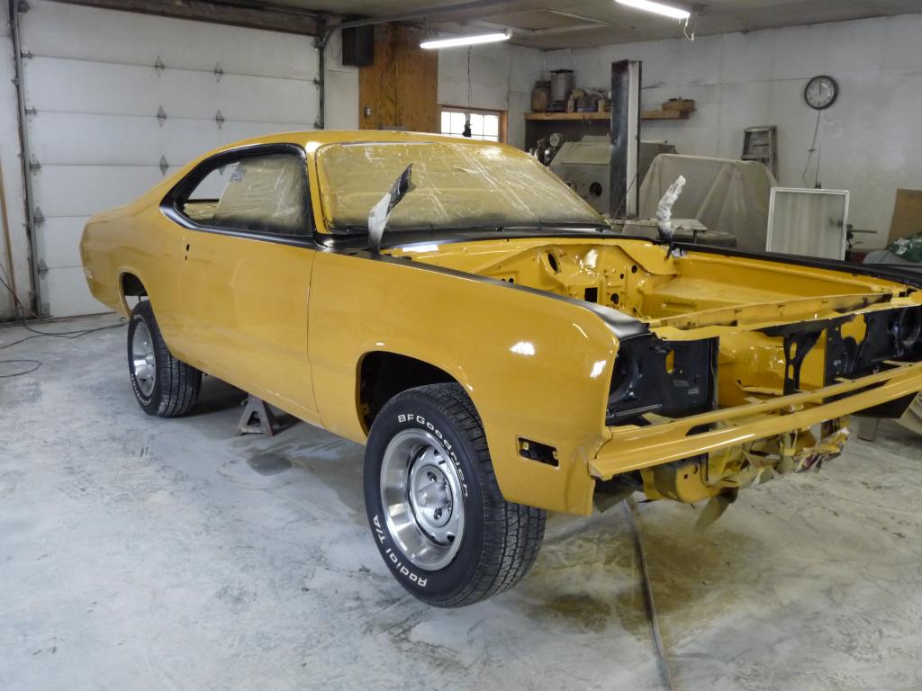

Thanks for the reply Ed. Due to the class rules the only wheel choices are the ones we have or the rallye wheels. They did not have an aluminum wheel option in 1971.
We were hoping for some return on a rather large investment. How about some of the trick coatings or treatments that are applied to the ring gears and bearings ? It sure does sound like all together we would realize some gain. If we end up doing it, we were thinking of doing the switch at the track for a real comparison.
Thanks
Gene

Can't give you exact A-B comparision but so far I'm not convinced, my theory is axles,spool,gears won't make as much difference as parts of bigger diameter such as tire. I believe smaller diameter less difference it will make.
If you are'nt making any other changes maybe you can tell us on here for sure. LOL
I like the car, how much does it spin? picture looks like tire is hooked pretty good are they regular old compound,or are they a some kind of soft compund,thinner sidewall version?

The launch is barely above idle and you roll into it. How fast you roll into it depends on how well the track hooks. For us MIR has the best hook all season hence the best 60"s and best ET's.
The tires are reproductions purchased from Kelsey tire. No real tricks but a little prep goes a long way.
We have raced at various tracks including Lebanon Valley, MIR, Cecil, US 131, National Trail , Virginia Motorsports Park, Englishtown and Beaver Sprimgs. Not every track each year but we do travel.
GeneWilsey is offline   Reply With Quote
