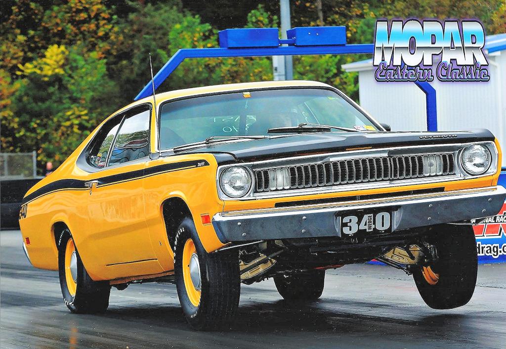

I do not have a stock or super stock car but my son and I run in the F.A.S.T. series ( factory appearing stock tire ) with a 1971 Plymouth Duster. We have to run factory casting number correct intake manifold, exhaust manifolds and heads with full exhaust and polyglas tires. The car also has to have a stock appearing interior. The motor is a large small block that makes 480 HP. So far we have run a best of 10.79 @ 123.87mph.
We have picked the brains of some local upstate NY stock eliminator racers and they have helped us setup the stock appearing suspension The best 60 foot so far is an 1.54. Over the winter we are looking to change the rear end from a stock housing, steel spool and 35 spline axles to an aluminum spool, aluminum housing, lightened gears,and gun drilled axles. Has anyone done this to see what the real world gain would be? Thanks Gene |

Sounds cool I would also add a 904 & Aluminum driveshaft. Keep us posted that's how we all go faster.

WOW! That is flat amazing! Beautiful car too.
Is there anywhere on the net that we can read more about the car? Keep us posted on your updates.

Yes there is a site to check (F.A.S.T, Factory , Appearing, Stock Tire) ! There is a SS/AH racer that has a car like this !......It's a lot of fun from what he tells me ! There's a picture if the Demon on there web site cover ! Type in the above for the site !.........John

If you don't have a Pro Trans, spend your money there. The housing ain't worth much if anything and doesn't fit well. That is a pretty hefty dollar to do all that stuff. Aluminum shaft is not too expensive. I assume you got Cal Trac's already. How about converters? I might have some stuff. Jeff Teuton jefft@southlanddodge.com
