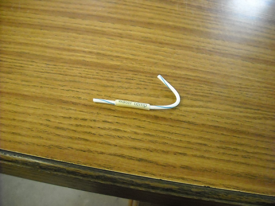

On a suggestion,
print sheet of desired text on office printer, cut to size with scissors, slip inside clear shrink tubing. Here is a scrap test wire.
Vola, cost of new label equipment = "Zero"

Default Re: re-visit of heat shrink label maker
That stuff is only $15 for 50 feet on Amazon. I didn't even know they made it clear.
Shop Woodfin saves you money!
