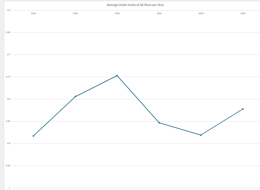

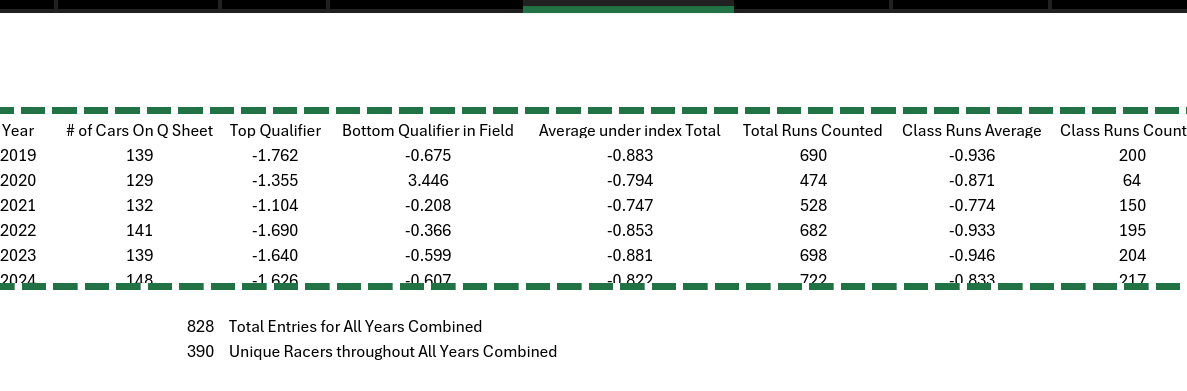

Default Re: index lowering
Originally Posted by Herbie Null View Post
Great job on the data Avery, it really shows how we as a collective group can askew the data in performance when a certain percentage try to get their average below .850 so a HP hit does not come our way. When you take a look at INDY qualifying the last 2 years it would be cool to see how that data aligns with yearly AHFS data. Indy data to me would be the real performance data since the AHFS is turned off. I really believe nothing is coming from all of this, just continue to slow those cars down for the averages is the new game.
Last Data post maybe ��. Cause I am a man of my word, Herbie I did one better and looked at the last 5 years. Here is the simple version of the data. Note I removed any runs that were not below the index to limit the sample bias. Please look at the attachments as trying to transpose tables does not work very well. There are things to consider when looking at the data like weather conditions.
Year # of Cars On Q Sheet Top Qualifier Bottom Qualifier in Field Average under index Total Total Runs Counted Class Runs Average Class Runs Count
Year # of Cars On Q Sheet Top Qualifier Bottom Qualifier in Field Average under index Total Total Runs Counted Class Runs Average Class Runs Counted
2019 139 -1.762 -0.675 -0.883 690 -0.936
2020 129 -1.355 3.446 -0.794 474 -0.871
2021 132 -1.104 -0.208 -0.747 528 -0.774
2022 141 -1.690 -0.366 -0.853 682 -0.933
2023 139 -1.640 -0.599 -0.881 698 -0.946
2024 148 -1.626 -0.607 -0.822 722 -0.833
ID:	71649   Click image for larger version
