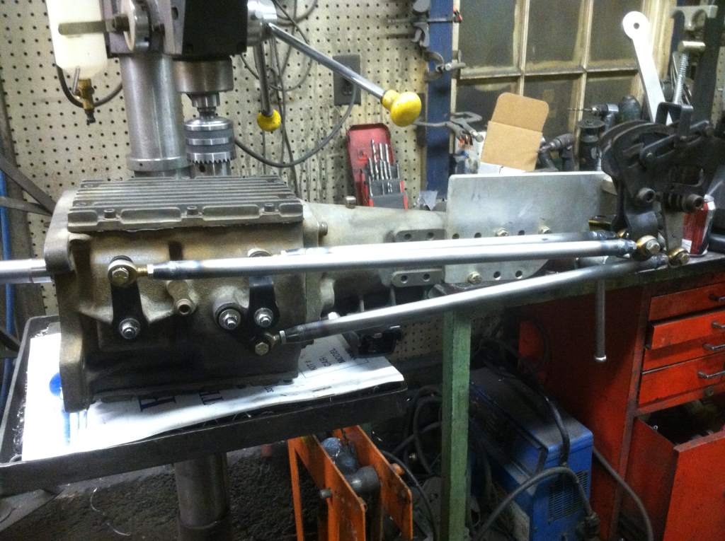

I converted Eric Merryfield's Drag Pak to a stick and did a mechanical set up .
We didn't feel it would be possible to keep the hydraulic unit consistent on reaction times ,plus you have little control over the air gap.
With a Z bar ,you can create many different ratios to change reaction time .
Hey Tom,
Would you consider selling me a Z-Bar for my Drag Pak? That would save me a bunch of time in design work.
Todd Gross
3323 FS/E,F

Hey todd.my dp is currently having the clutch linkage fabricated by Andre Mailloux.your more than welcome to come and look at it for ideas.i live not to far from you.every thing Andre builds is unbelievable.
