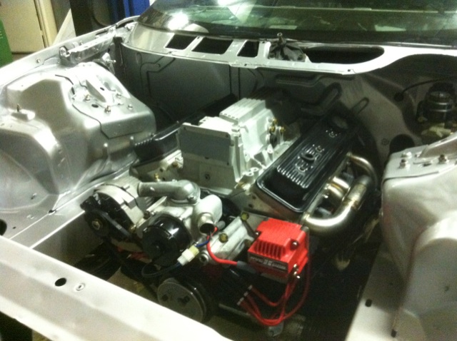

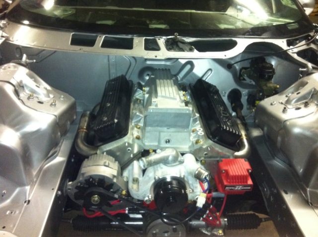

Got my motor all buttoned up and put in the car. The only thing i have left is figure out is which injectors i need to run.
Will the stock injectors work (24 lb. I think ?) or do i need to upgrade to a slightly larger injector (Around 30 lb.)
The car has a BS3 management system.
I apologize in advance for my lack of knowledge. Any help would be appreciated.
Chris
Just a couple pics of the painted engine bay.
